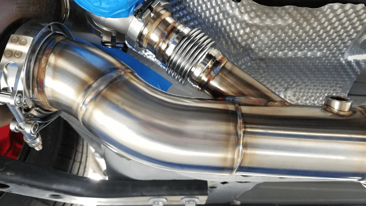

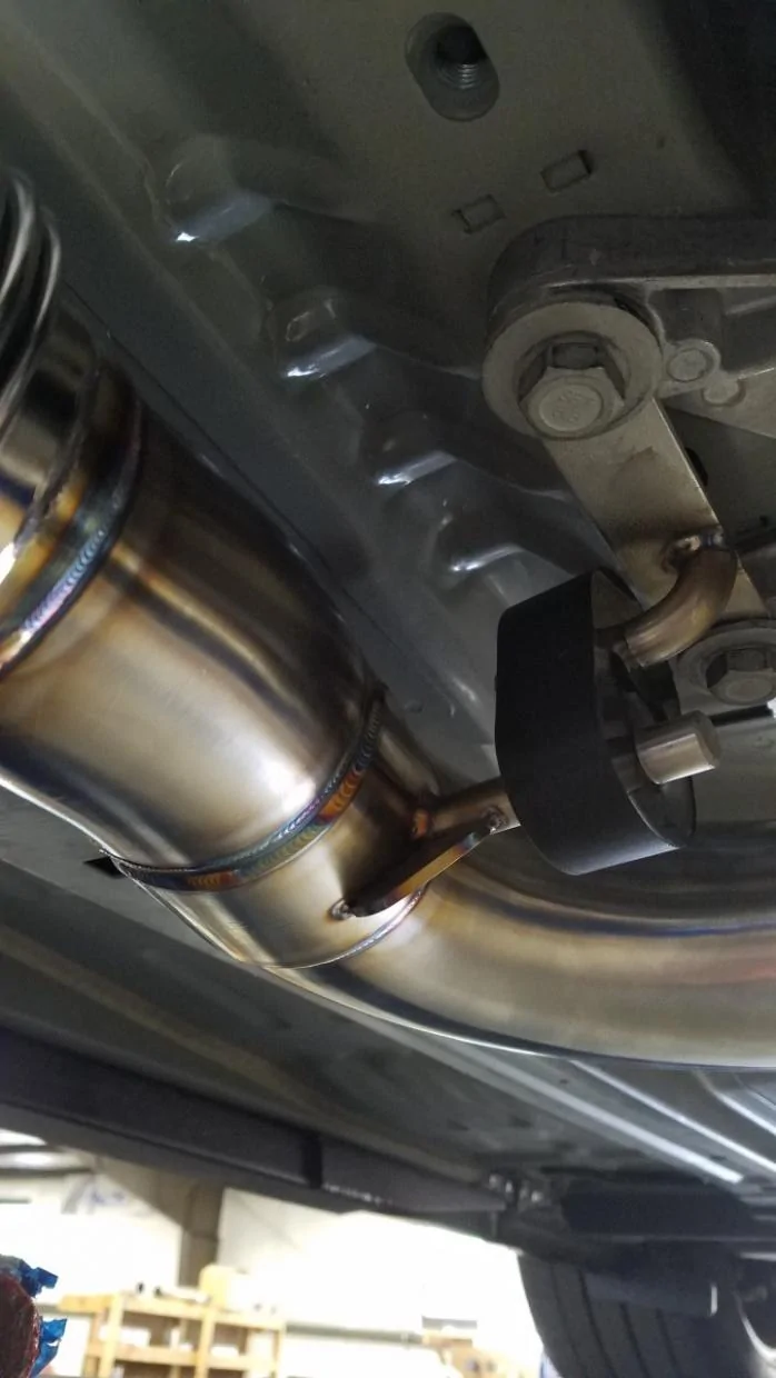

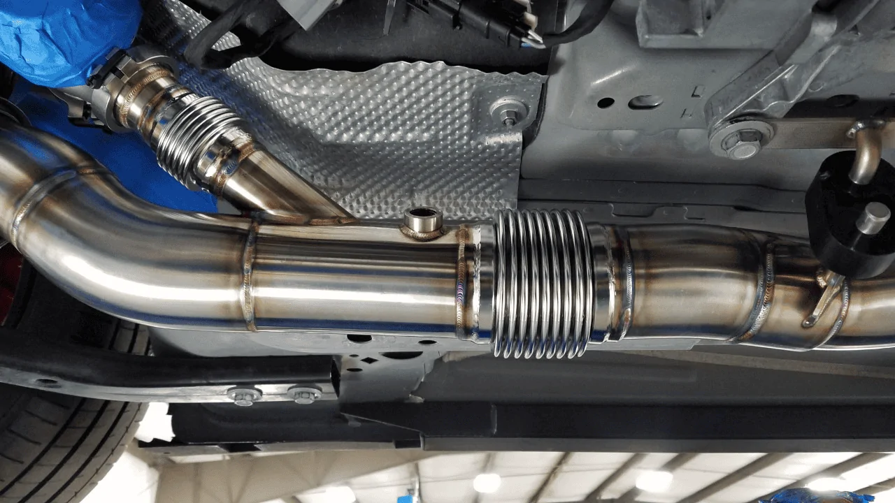

These were shared with me today by Ben at Fathouse!!

That is a very very nice build. That car will truly be in beast mode when completed.

Quality of work looks simply outstanding.
Going off the work I've seen here, I'd have no doubt in shipping my car to them for a custom turbo build.

Amazing welds and attention to detail. Can't wait to see the final numbers.
