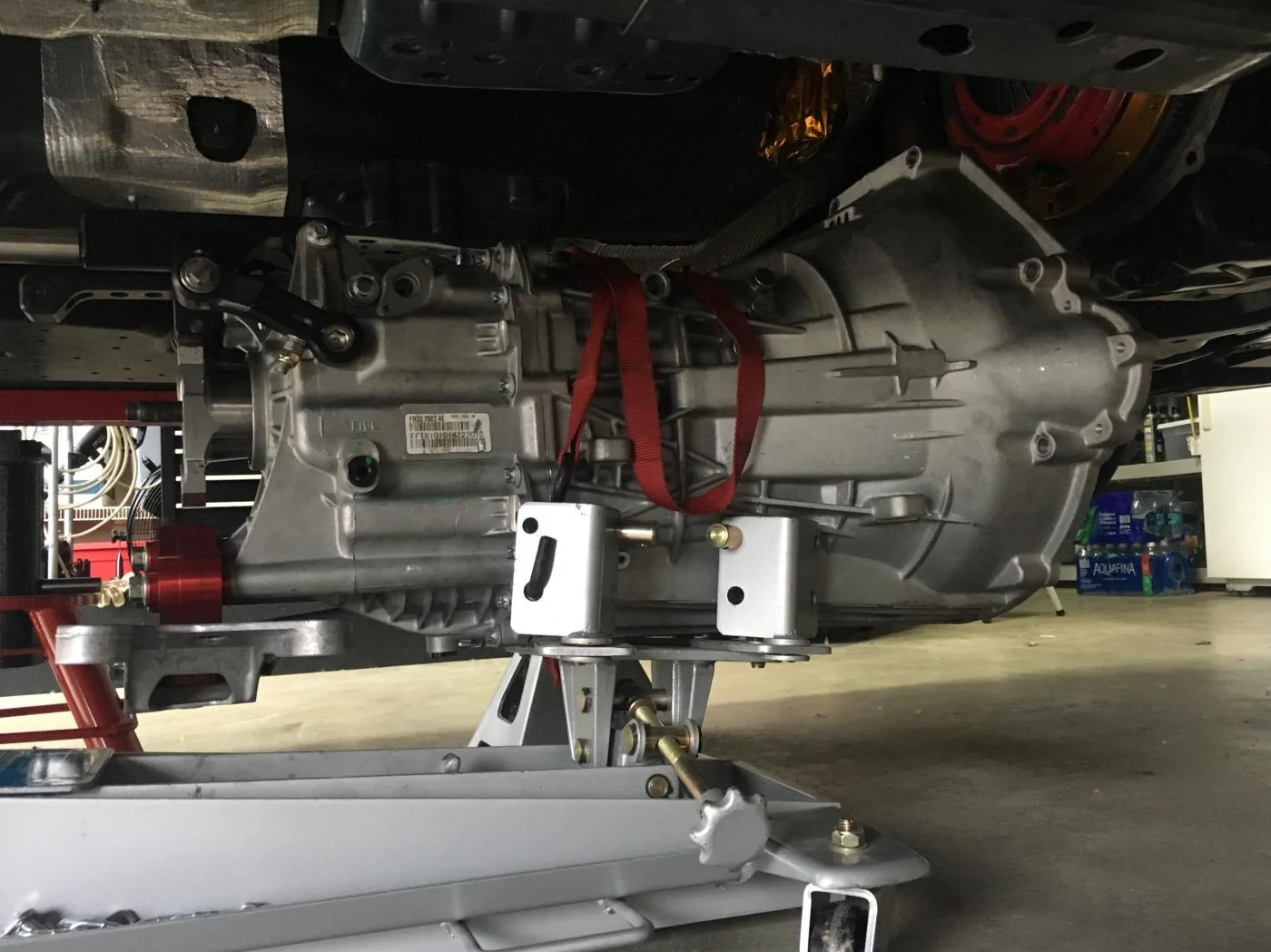

I removed / installed the trans but I let a local Chicagoland trans shop that specializes in Tremecs, Powerglides, TH400s, and ring & pinion swaps handle the rebuild (this was there first MT82). I know the owner so I was able to see it all disassembled and how it goes back together (I should have taken pics). There is a 5 or 6 part vid on YouTube that shows how to rebuild it if you want to see what's involved. He did mention that you need a pretty robust press.Rainmaker, did you do the gear install yourself?
If so, any specialty tools required?
Never taken apart a tranny before, but im not afraid to get my hands dirty
