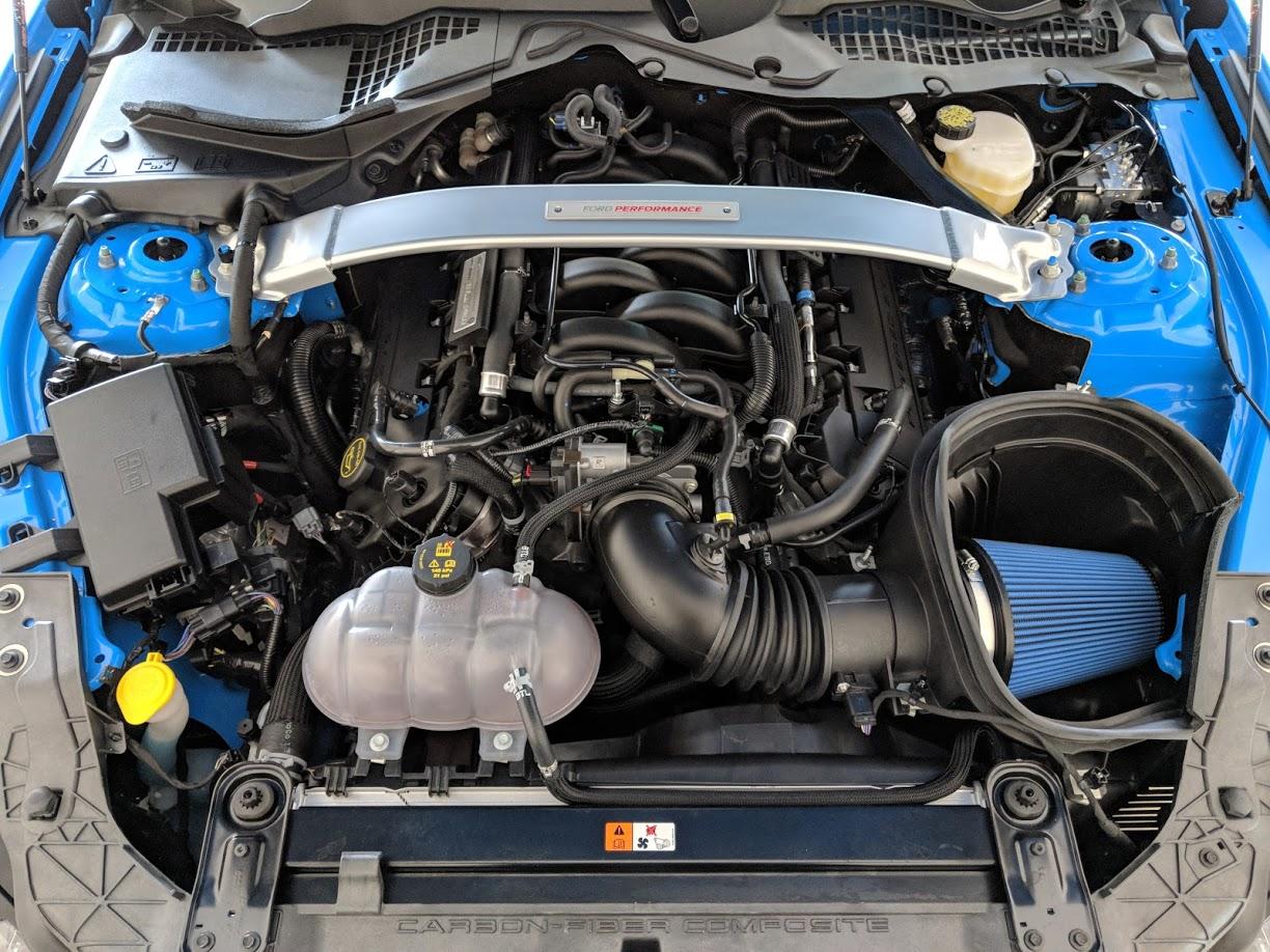

Been sick the past few days so just ordered some goodies for Black Friday and installed an Airaid filter.
