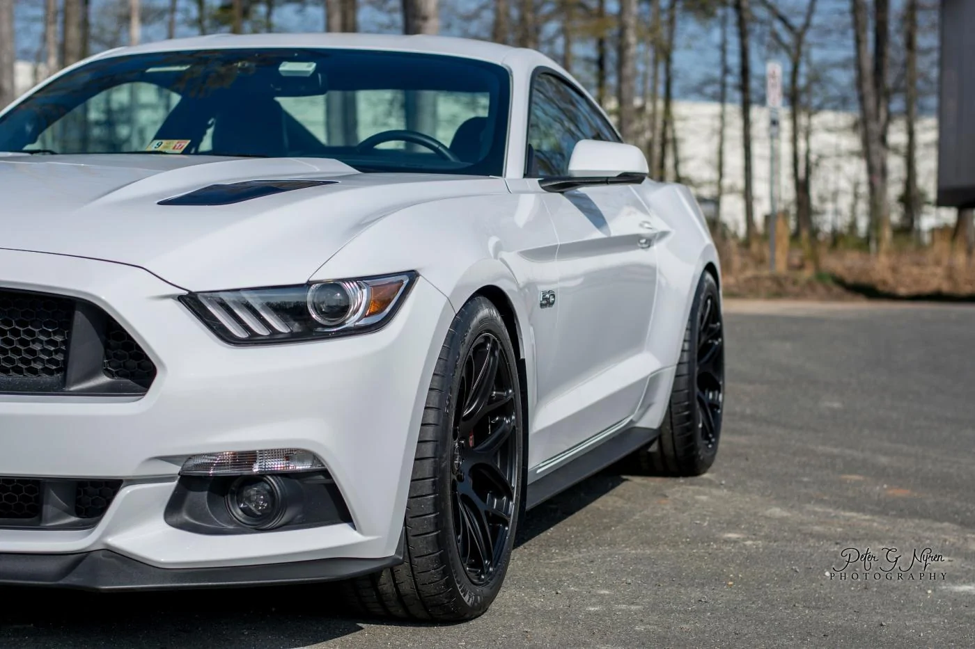

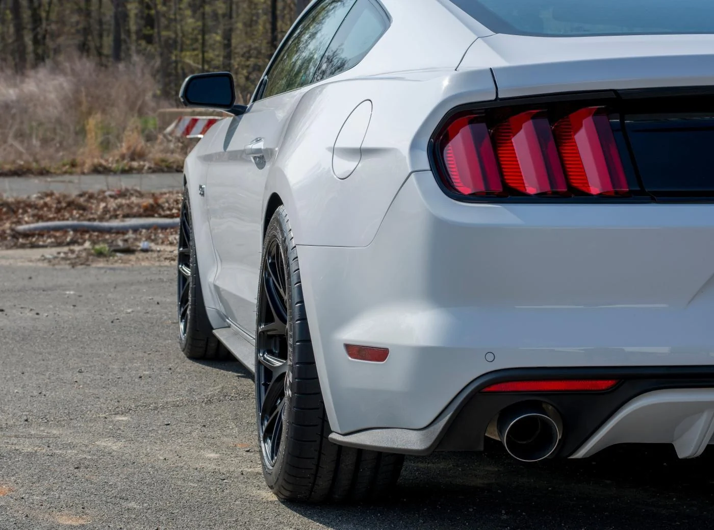

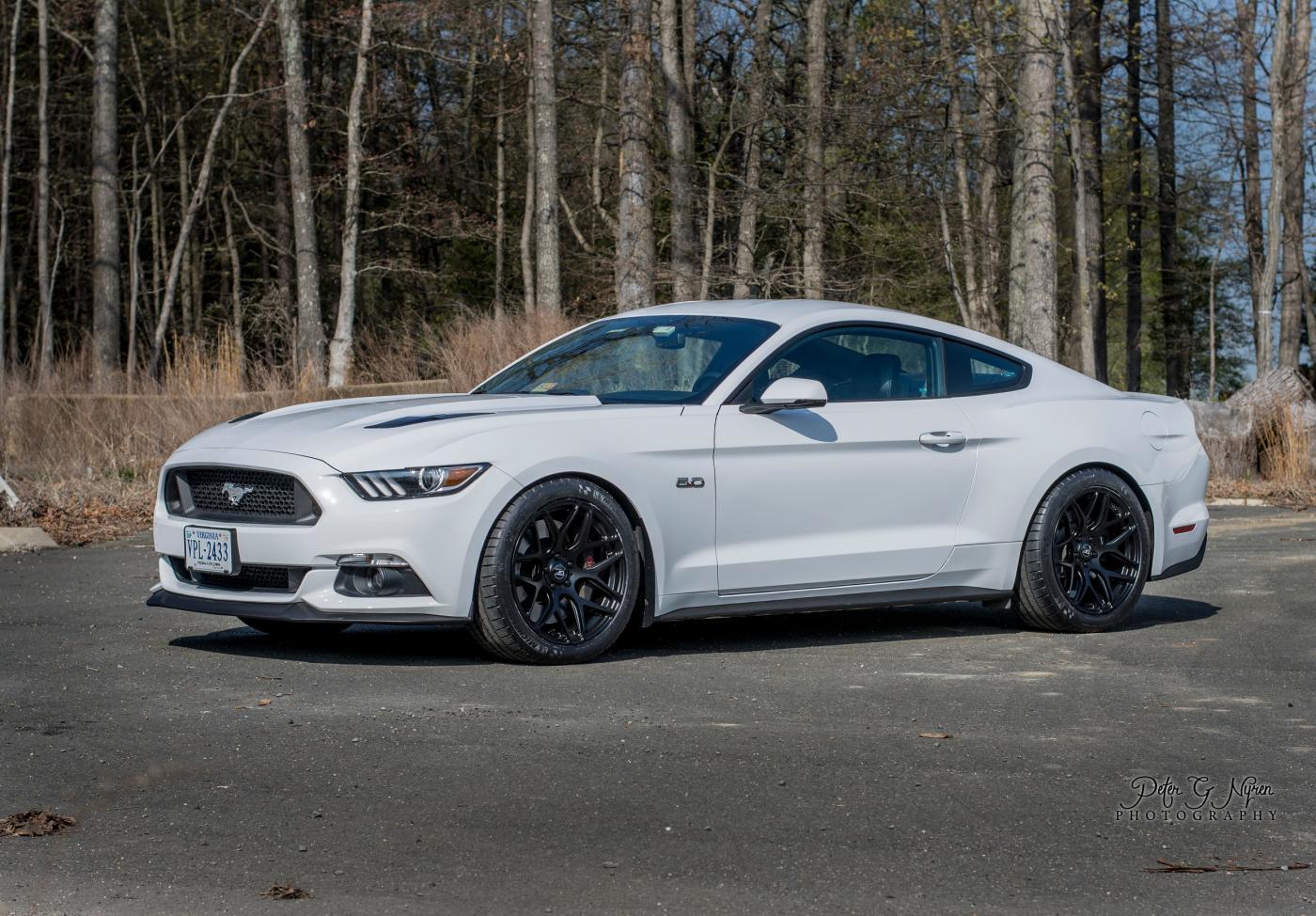

2. The Ford Performance Kits come preassembled with what I understand all parts needed for the install. But I don't like the stance of the car with the springs (front looks a bit higher than rear), which would mean that I would replace the springs with Steeda Mustang Ultralite Springs. But I don't know if this a good setup together.
