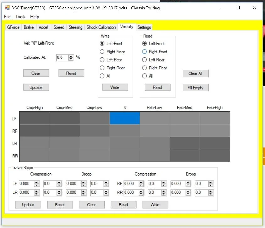

Do you get to make separate settings for front vs rear dampers?2. they don't calibrate like regular shocks. It's a whole new world. They start with a double triple adjustable shock with high, medium and low speed settings for compression and separately for rebound.
Yes I have it and the post you saw might have been mine. I really like it.Do you in on one? I saw some guy posf who owned it who liked it.
Here's a screen shot of the velocity tuning screen. You can see the row of tabs across the top.Do you get to make separate settings for front vs rear dampers?
