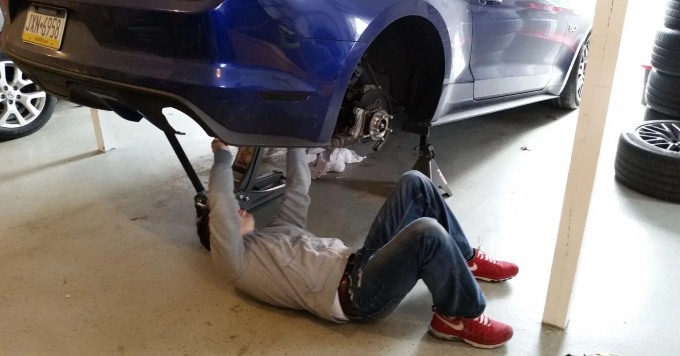

Hi All,
Spent the weekend dropping the IRS and installing these two sets of solid bushings for the diff and IRS mounts. In terms of difficulty, I would rate this less difficult than the LCA bearing install, but takes a significant amount of time. Took two pairs of hands 10 hours and a case of Coors to complete (the Coors may have increased the time needed. And by "may have," I mean "definitely.") Also took this opportunity to adjust the camber to a more acceptable amount after lowering the car months ago.
Except for the sawzall business, the install is generally pain free. Due to the success of the last post using BMR's install instructions, I am going to use that format again. Keep in mind, the install is slightly different for each bushing set so I am going to modify for both. I would NOT recommend doing these separately, may as well do both at once.
BMR’s INSTALLATION INSTRUCTIONS:
1. Lift vehicle and safely support with jack stands under the rocker pinch welds.

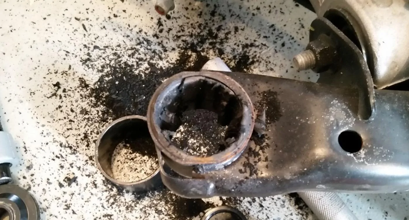

18. The factory differential bushings are pressed in. The simplest way to remove these bushings is with a Sawzall. Force the blade of the Sawzall through the void of the bushing until it goes all the way through. Cut outward through the outer steel sleeve. It is not necessary to cut completely through the sleeve, a small slit in the outer sleeve will relieve enough tension to knock the bushing out.
-Step 18, I HATE you. We tried everything to press, pull, drill, and cut out these bushings. After 8 beers, ounces of sweat in a 45* garage, and 2 cigars we finally had the best procedure for cutting these out. Step 1, use a wood blade for the sawzall and cut around the metal centers in the bushings. Step 2, replace the wood blade with a bi-metal blade and cut the metal shroud around the rubber. Be VERY careful when cutting these. With all the rubber around, it is tough to see/tell when the bushing has been cut thru and you’ve entered the IRS metal. We found a different sound could be heard. Although we couldn’t hear much as our ears were ringing significantly after cutting out all 8 of these. (plus two for the toe link bushing replacements). Most of the time was lost here. 6 hours gone and 6 beers remaining in the case. Has to get better from here, right?
19. Once the tension is relieved, knock the bushing out with a large hammer.
-Easy and highly satisfying after my soul was removed by vibration from my body during sawzalling.

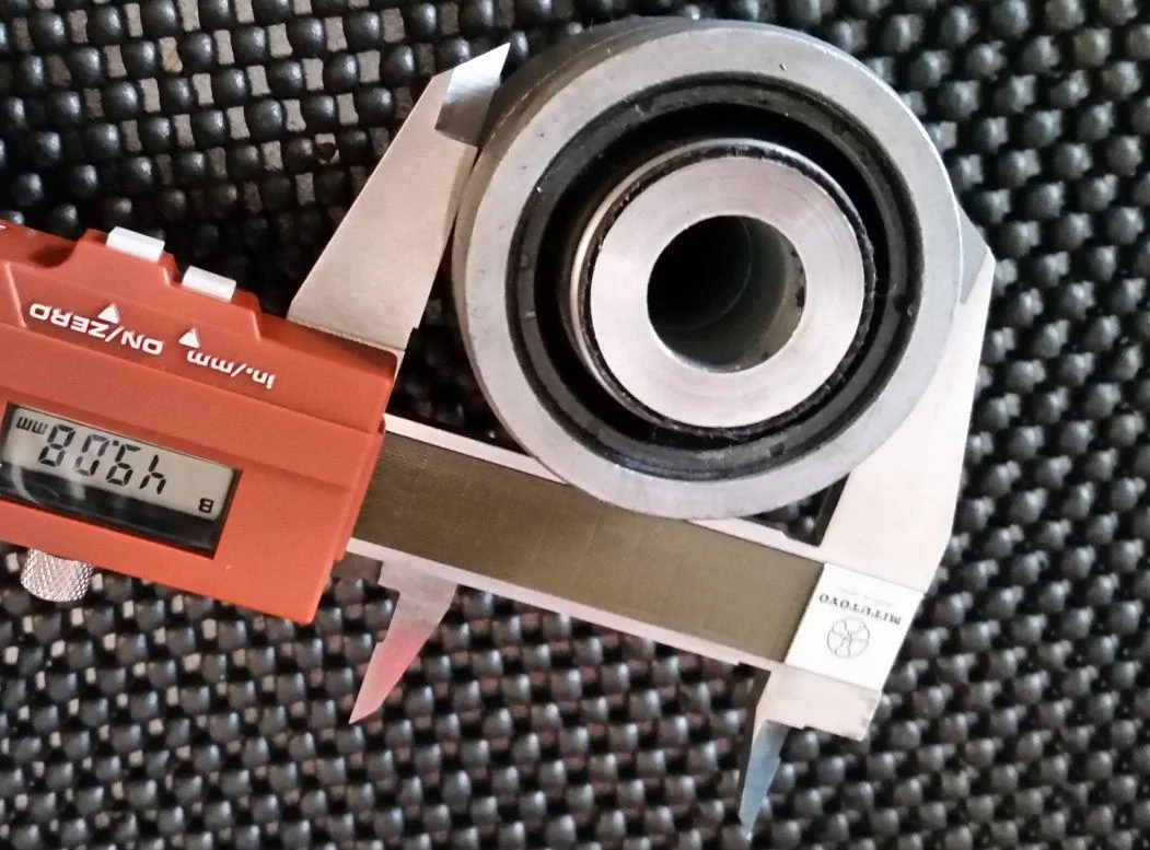

20. Your BMR aluminum differential bushings should be installed with the flange side on the inside.
-Evidently I missed this notice as I e-mailed Kelly for help. Probably should have perused the directions before spending 6 hours wrenching and 10 beers deep…
Using a large rubber mallet or preferably a heavy dead blow hammer, knock in all (4) BMR aluminum bushings into the cradle. To avoid rattling, BMR machines their bushings on the tighter side of the scale. Be aware that it takes a significant amount of force to fully seat the bushings into the cradle.
-BMR bushings all fit tight, but went in smoothly. The FRPP toe link bearings DID NOT go in easy… I had to machine out 0.3 mm to make them fit and put the bearings in the freezer.

All in all, not bad. Time and patience is needed, but not many specialty tools. I think anyone can do this as we did, in a garage, on jack stands, and a case of beer. A special thanks to Kelly @BMRTech for returning my barely understandable e-mail for help. BMR makes great products; they all fit and were exactly as described. The only parts we couldn’t get in were the FRPP parts. This makes me very confident and glad to have purchased BMR products for the IRS mounts and diff bushings. Thanks again BMR. Now hurry up with the front suspension brace!
Also, if anyone is still reading this, I overzealously ground one of the toe link bushings down too much and now it is loose. Any suggestions? Shims? Weld the bearing to the mount? I have to take it in for an alignment anyways, so any professional operations can be ordered, opinions valued.
Pictures:

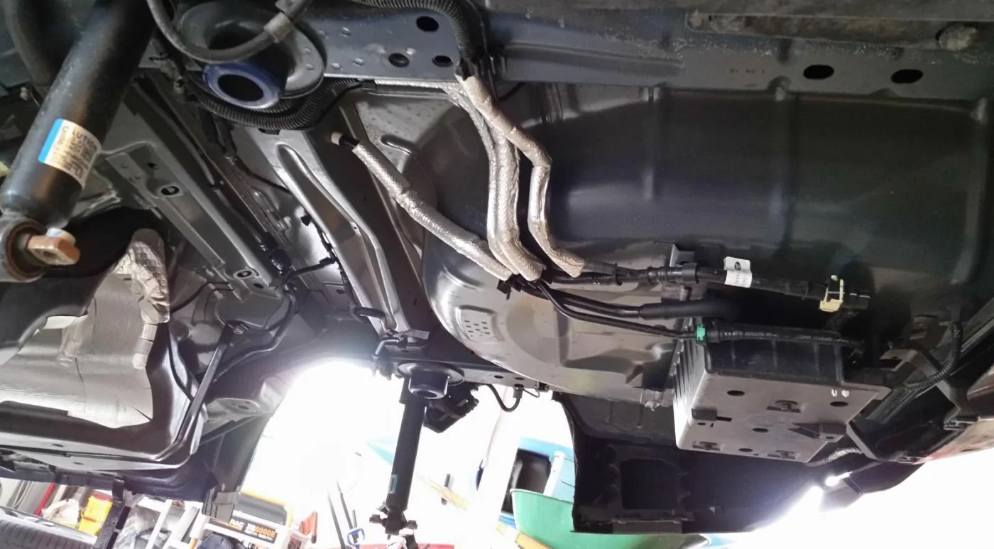

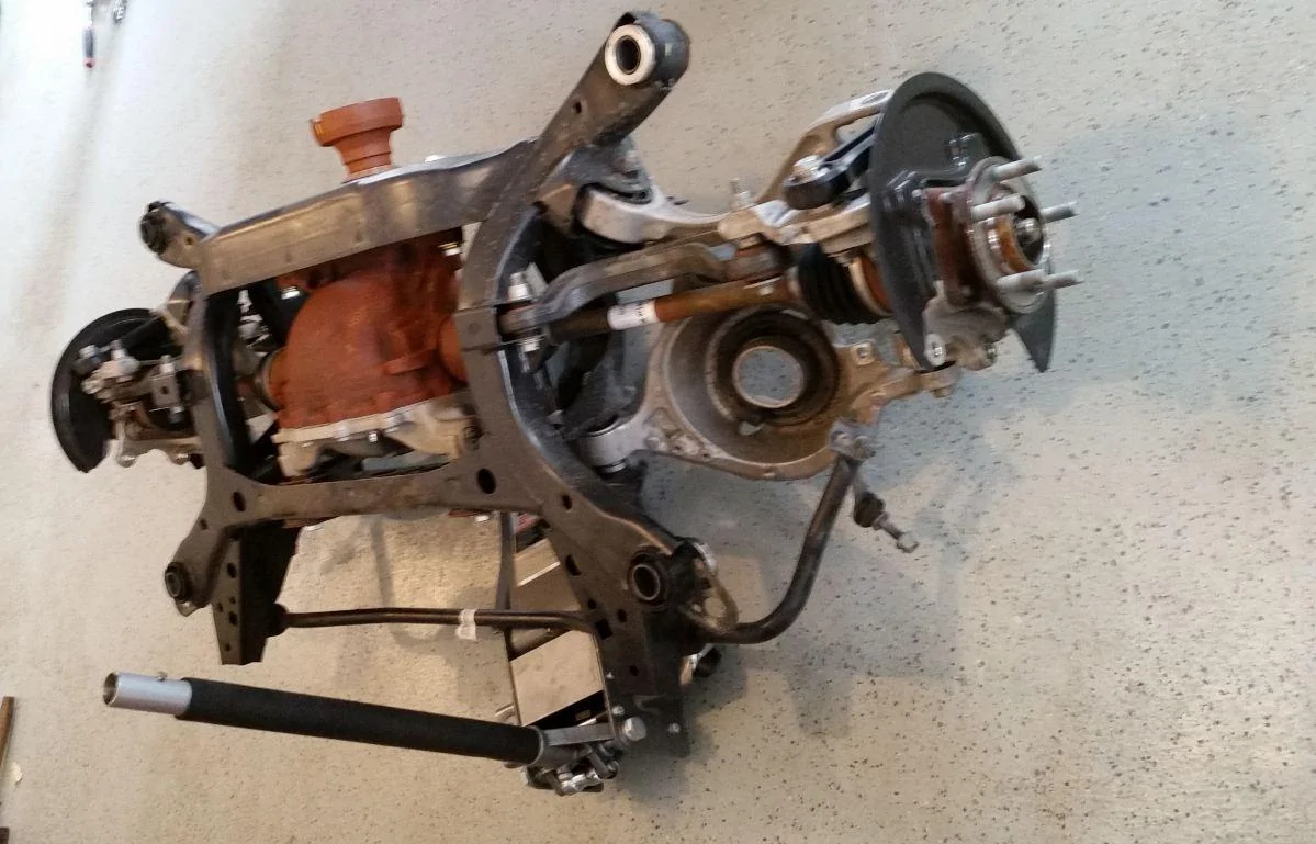

1. IRS coming out soon. Optimism and patience abound.

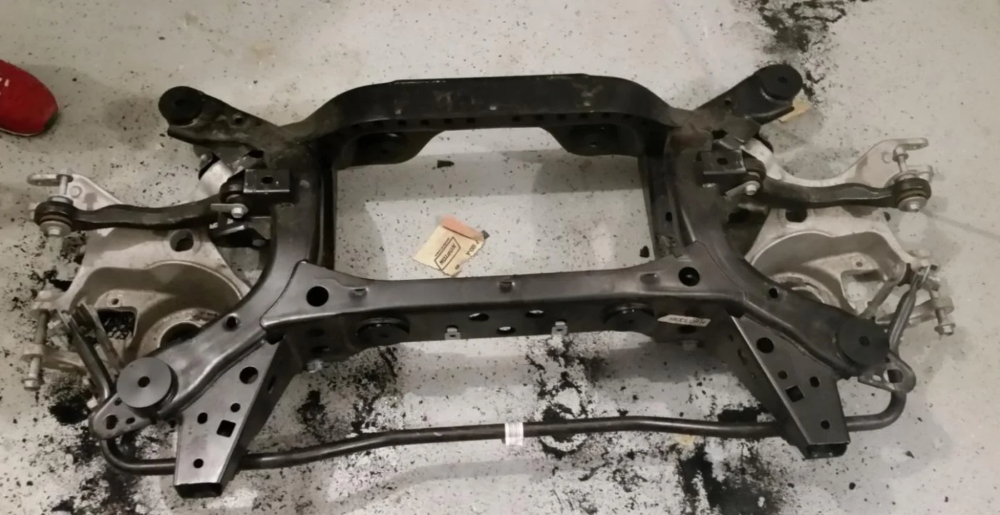

2. No IRS in car. So empty.

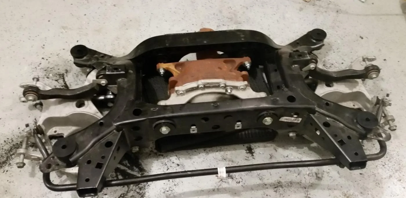

3. IRS on garage floor.

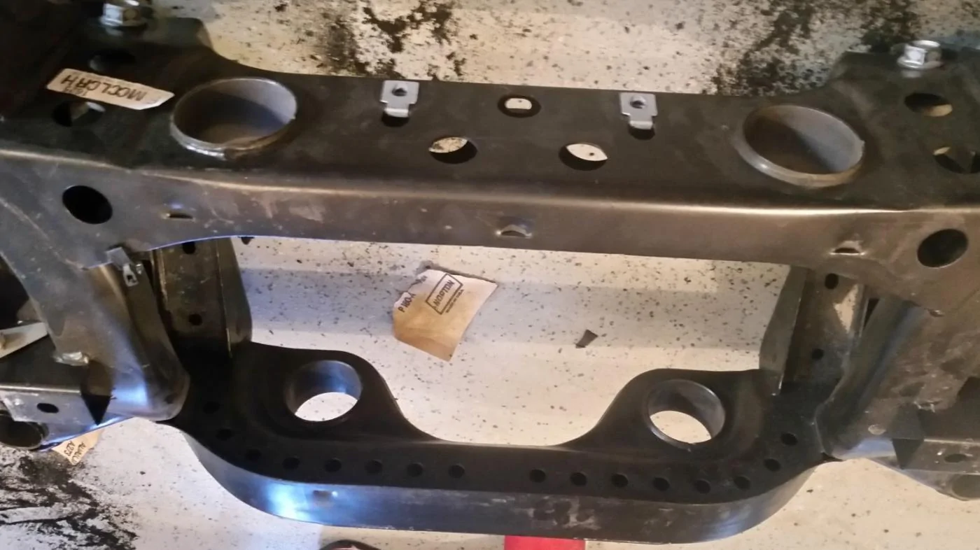

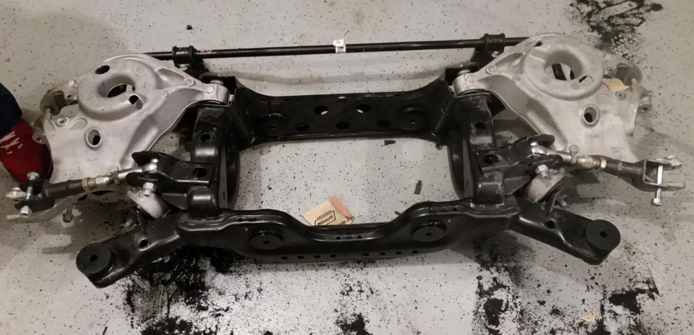

4. IRS without diff and halfshafts.

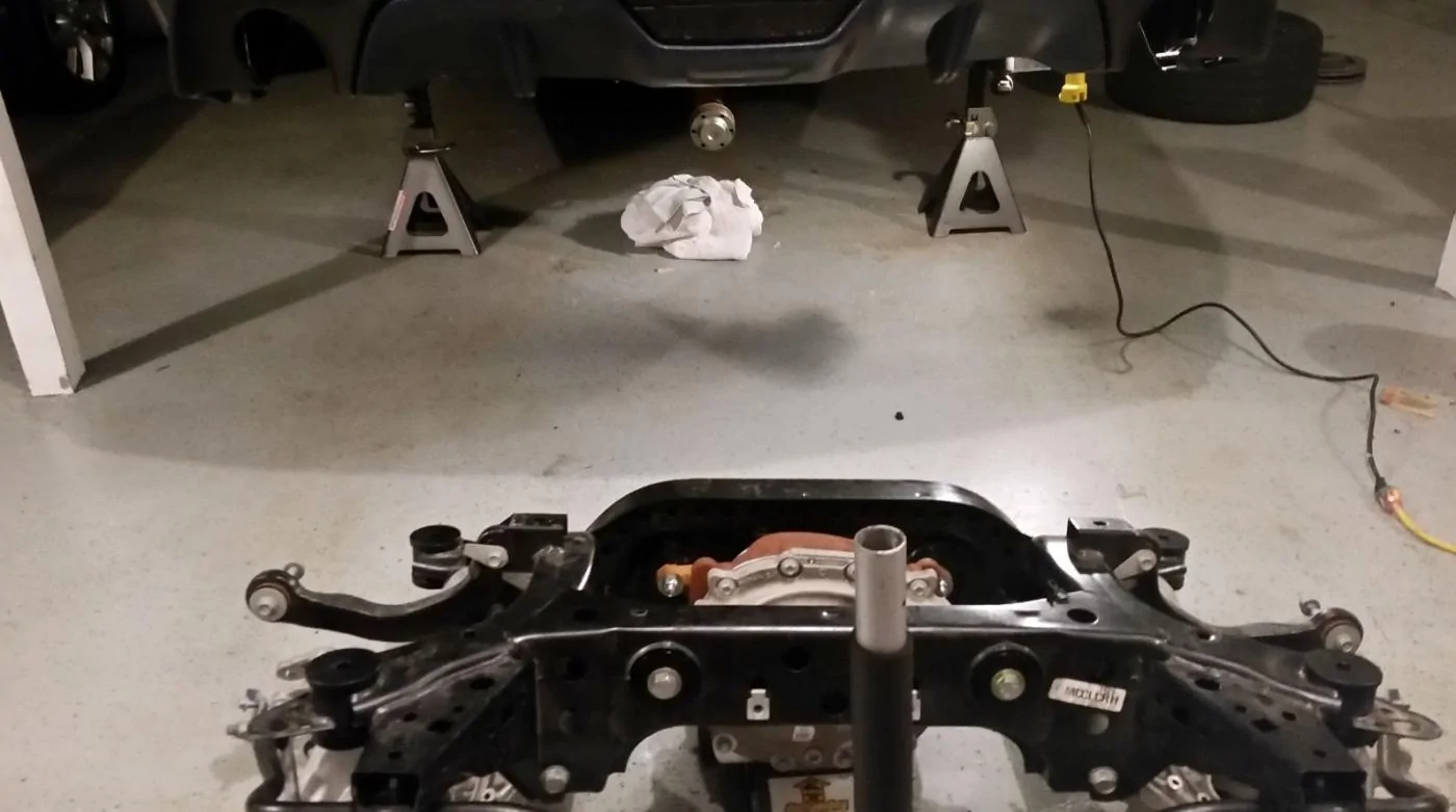

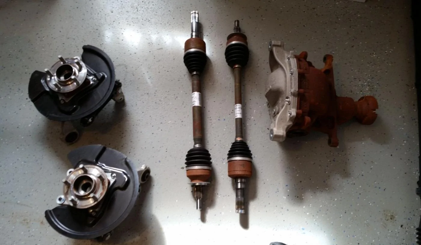

5. Collection of Parts! Halfshafts are different sizes…

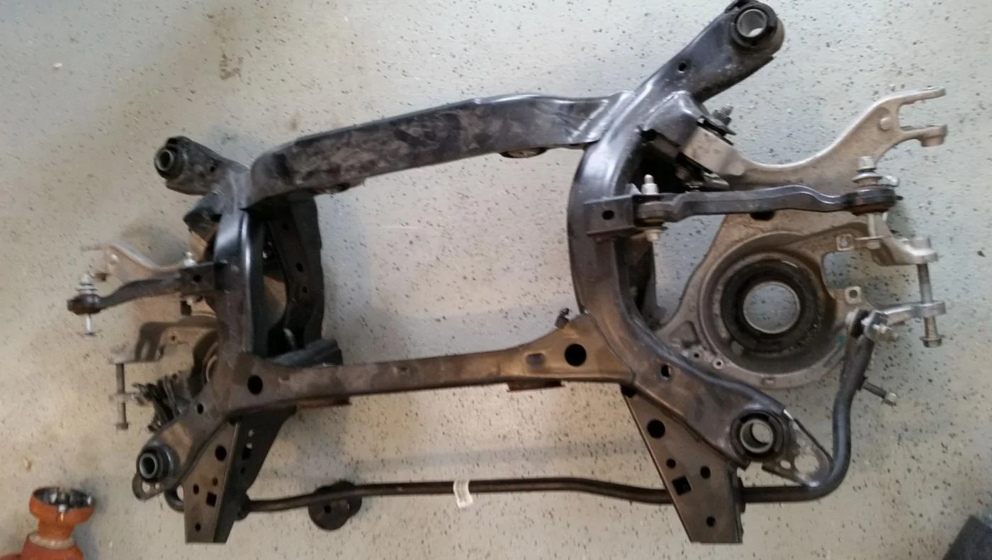

6. Drill and sawzall method employed. Stock bushing hacked to pieces. Next step, cut thru other shell then hammer out.

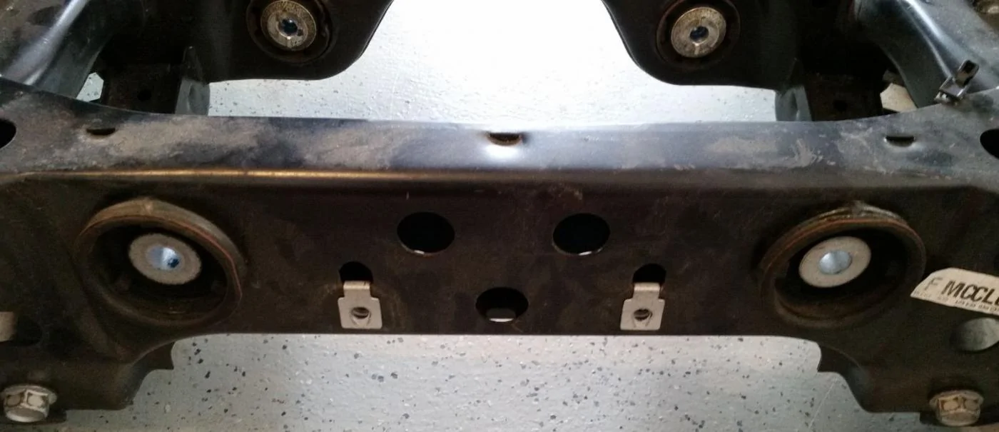

7. This is what the stock diff bushings look like. I wonder if those locating pins are important and why they are not included on the BMR ones?
8. Stock bushings completely removed.

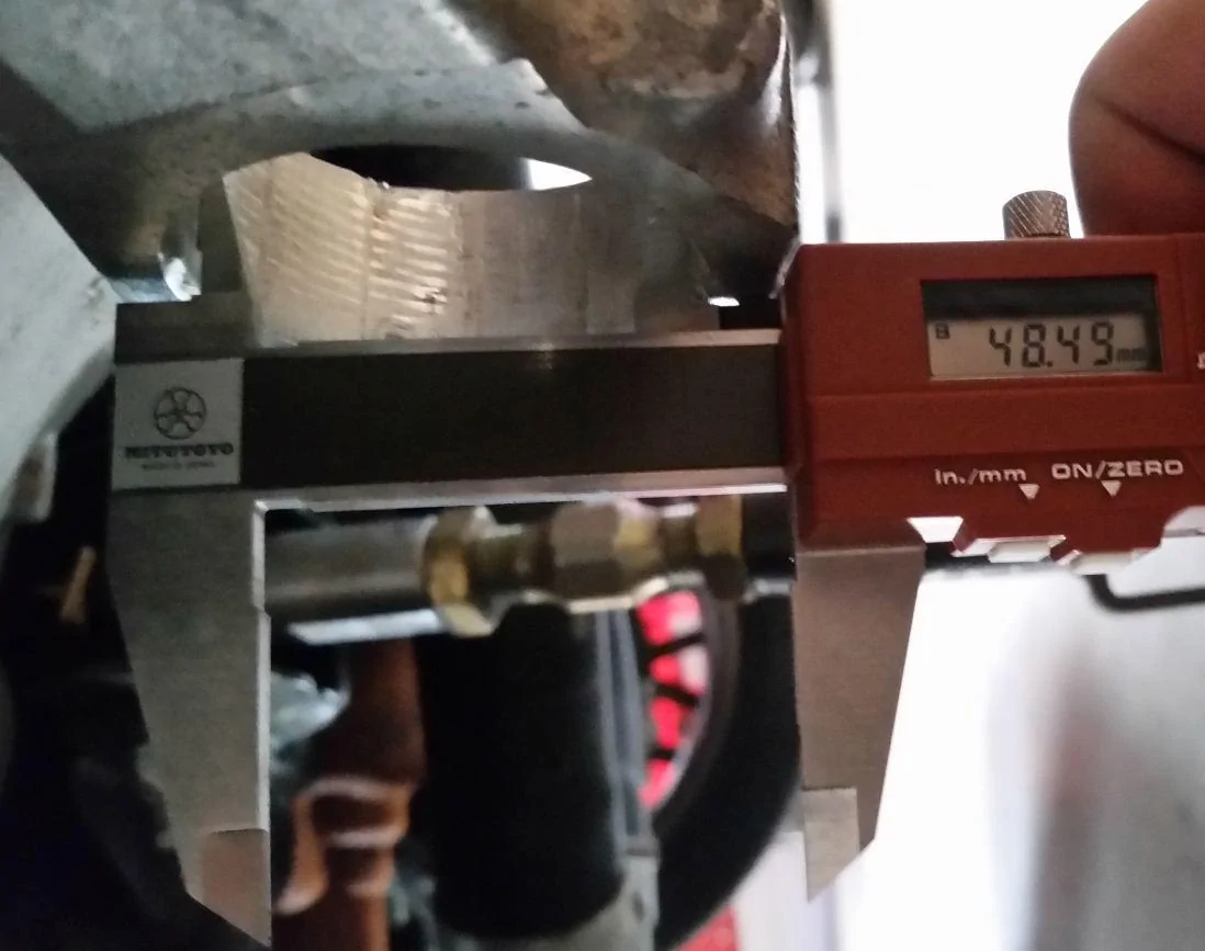

13. Size mount hole.
14. Lunch break!
15. Size FRPP bearing.

9. BMR bushings slid in.
10. Bottom view of BMR bushings.
11. Diff installed into new BMR homes. Lips in!
