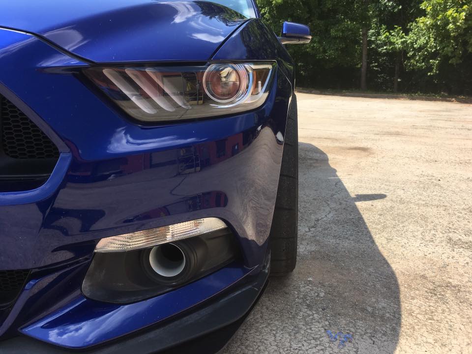

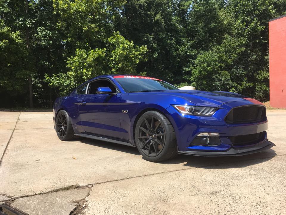

This is what my 305 square setup looks like, in case anyone wants to know.
SVE GT350 19x11 ET 50. 20mm spacer up front. Can use a 25mm spacer, too.
Worth noting, my car is only .75" lowered at all 4 corners. I run -2.5 camber up front, -1.9 in the rear.
I have no idea if a lower car could handle this setup or not. The 305 tire is approx 5mm away from the strut, maybe 3-4mm. It never rubs. It does contact the inner fender lining a little but nothing I care about.
