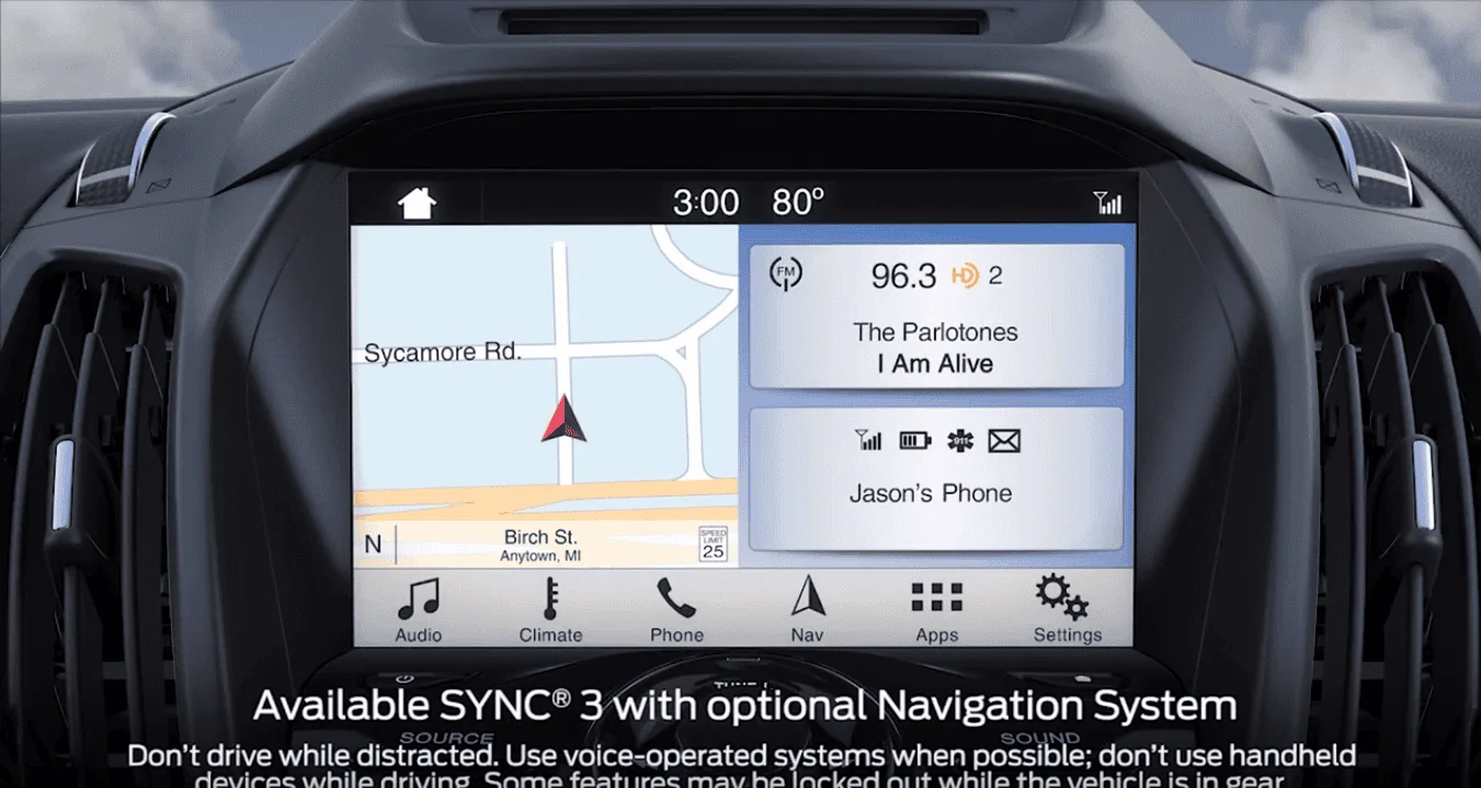

I like having the Sync Home Screen displayed with a longer range map with traffic, time & temp, my entertainment selection and phone status.
I have my phone mounted by the vents with Waze running in parallel.
With a glance I can get a nice overview of the dashboard. When I'm stopped in traffic I can check email by simply toggling betwen Waze and Outlook.

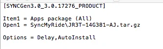

I have some good news, a friend from UK who shared the google drive with EU 17276 package said the non-nav version is in there, just gotta delete other files, heres his post
"Inside is one small file that only checks if you have nav or non nav version i did not know that before. But that does not matter. The only one new file that this newer build has is this app package: JR3T-14G381-AJ.
So you can delete all the files just keep this one and edit the autoilstall.lst accordingly:
Just rename the head line like this: [SYNCGen3.0_ALL]"
I feel like i'm going to break something, but i guess i'll give it a go!

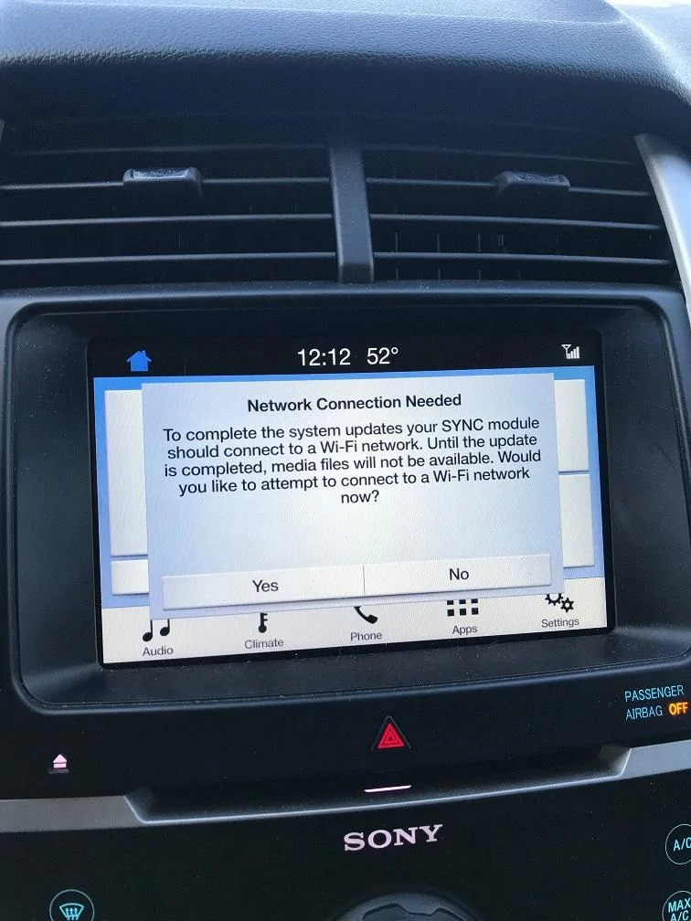

I tried this as well, on the system that came with the car... no joy.
I've read that the problem may be the phone.. I have the 3.0 cursed Galaxy S8.
Just to be clear though, since I posted last about that work around for the WIFI pop up, from the start 2 windows popped up, the WIFI one is gone, so I guess the process worked.... however I'm still stuck with this one, does anyone else get this?

click yes and connect to a hotspot or something, make it go away

Yeah dude. Just connect to a network already. Problem solved.
Did you do it? I would like to do it as well. Thanks :thumbsup:
