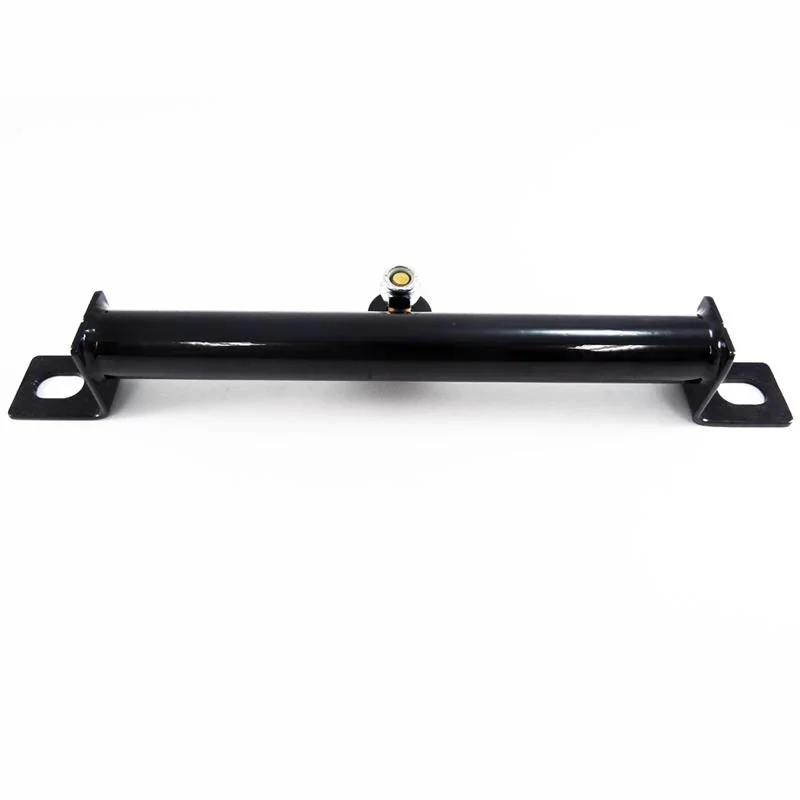

One final point. I didn't like the idea of mounting the 5th belt with a hole through the floor. There is a lot of stuff under there at the front of the seat and I was not at all sure I could get a strong mounting point without major surgery. A drag racing friend told me about the UPR crotch strap mount for Mustangs. It attaches to the seat anchors and can be installed in about 5 minutes. UPR is in Florida.
