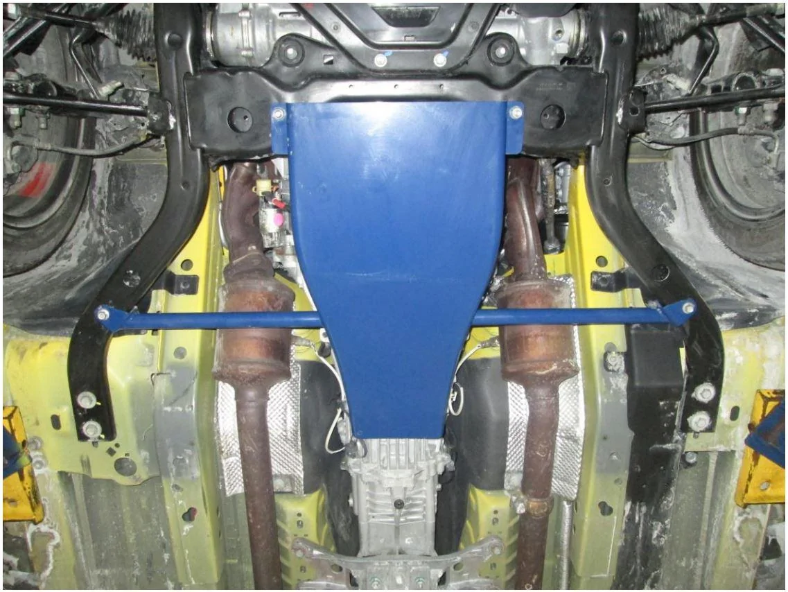

I'd have been more into the scoop if it looked like it was thermoconductive...they painted it..?
Can anyone inform whether there is clearance above the differential housing, between the floor of the car and the housing? Hopefully there are at least some substantial gaps..?
tia anyone who can answer this..
