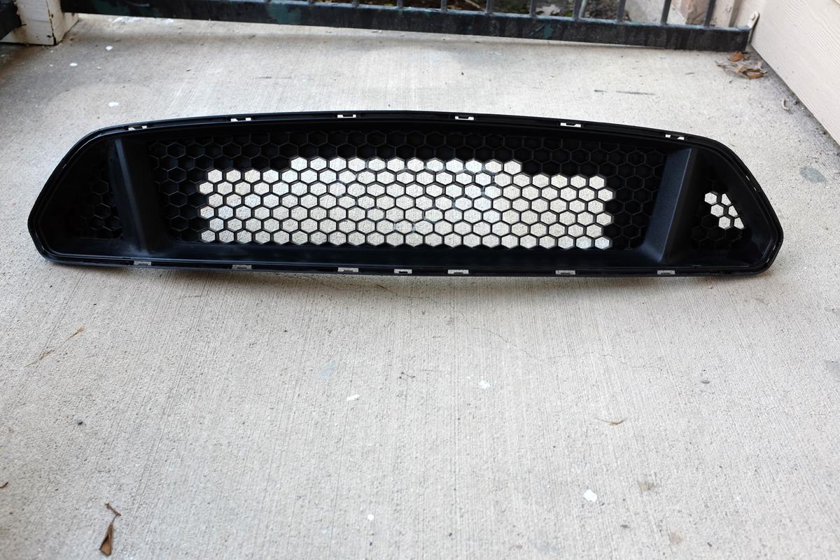

That's why if I try it I'll be buying an extra grille and not cutting my original grille. At only $45 it's pretty cheap. Also LethalPerformance says they just throw away the sections they cut out so I'm hoping to get some from them even cheaper. Hopefully free.Bugger, I was hoping it was much easier to delete the emblem from the grill.

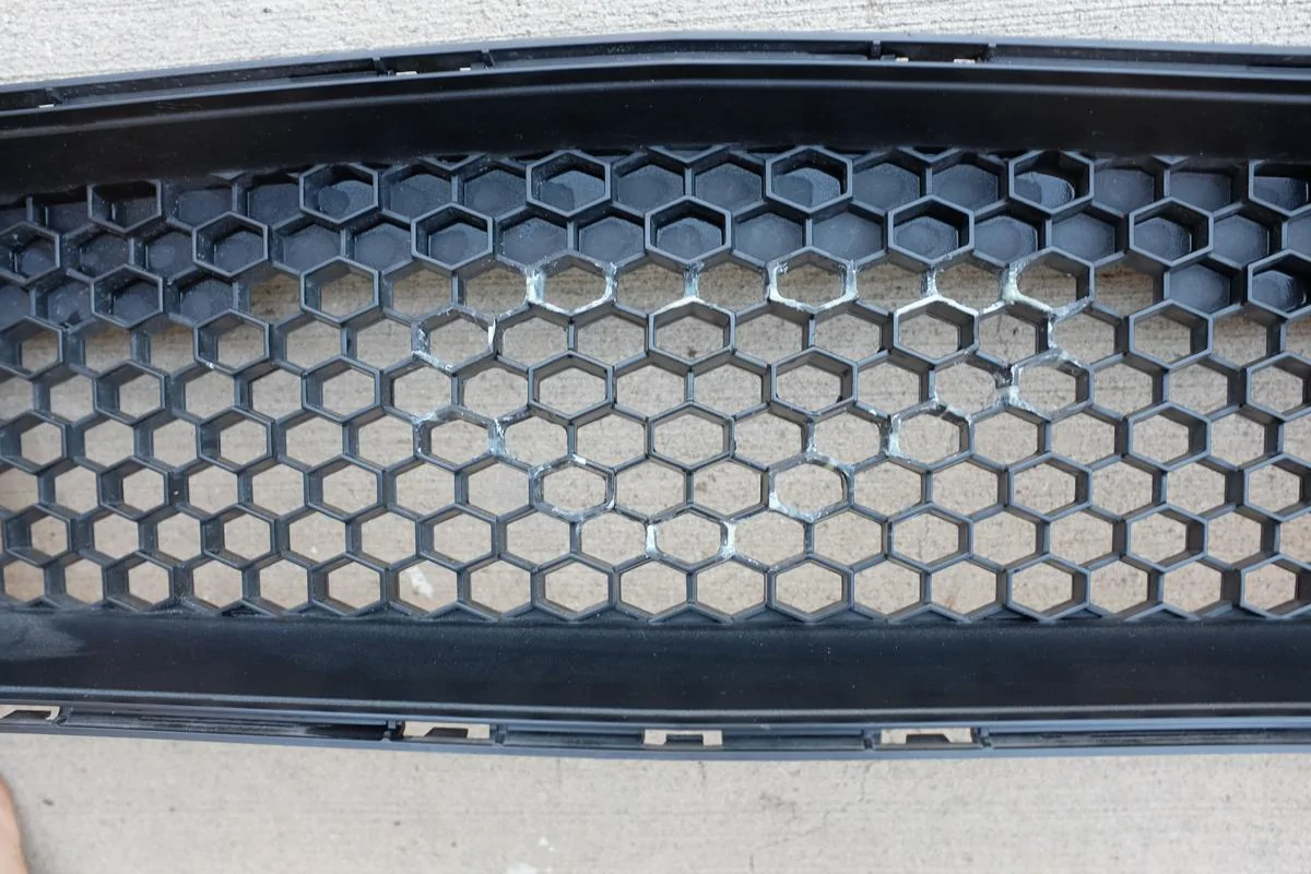

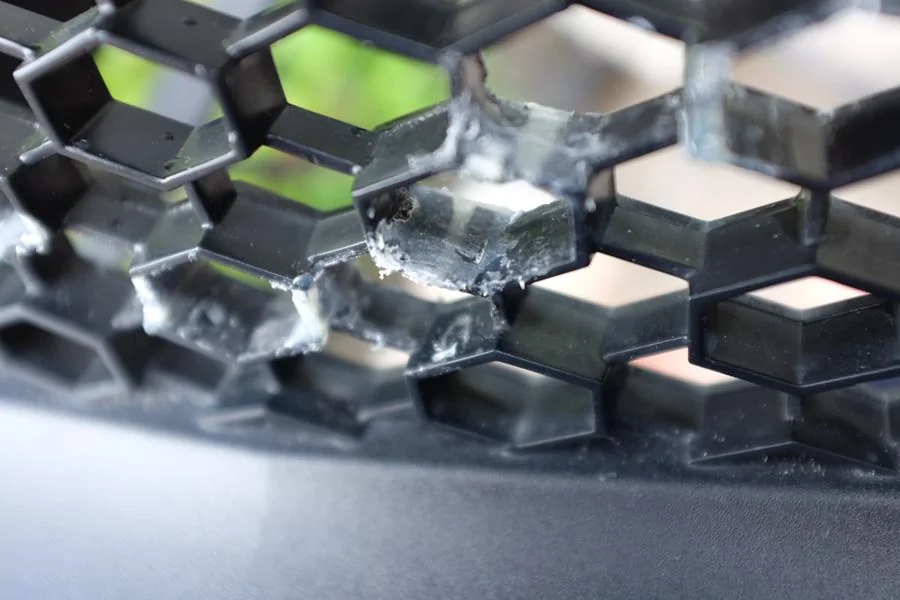

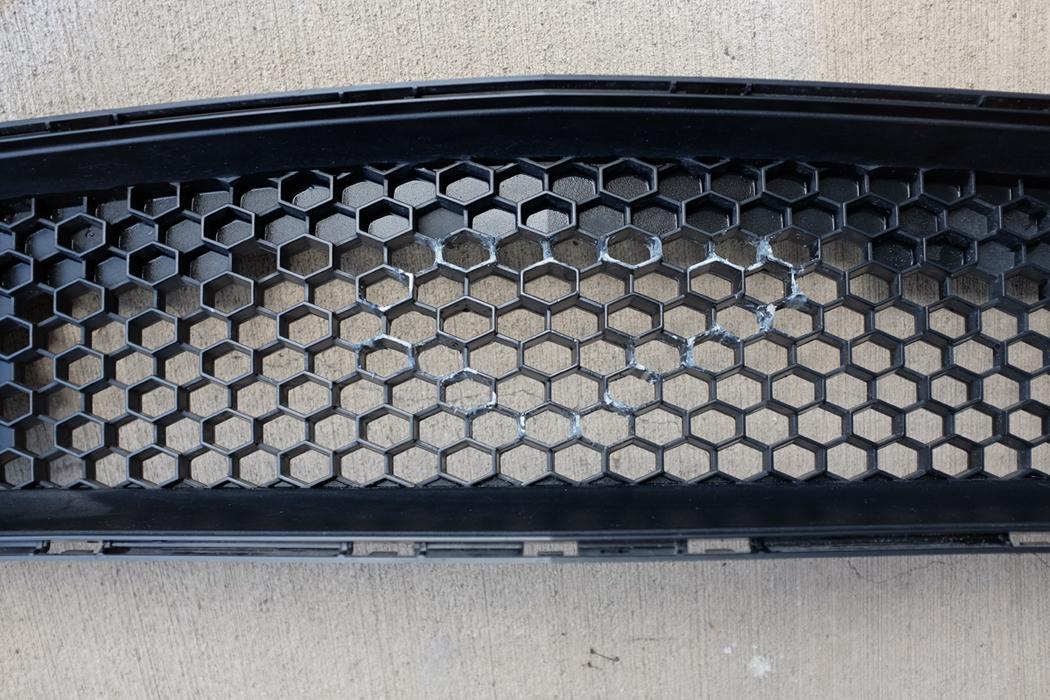

Don't have any problems now with the curvature. I stuck it in my oven at 300 degrees for 3-6 minutes before gluing and made slight adjustments to get everything aligned.Woo-hoo! That much closer. How's it looking as far as the curve you mentioned? What epoxy did you use? How is it holding up so far? Any advice or tips for anyone else wanting to attempt it?

Haven't had much time to work on the grille. I applied some bondo to smooth out the rough areas and started sanding it down with 80 grit.So how's it coming? Get it painted yet?
