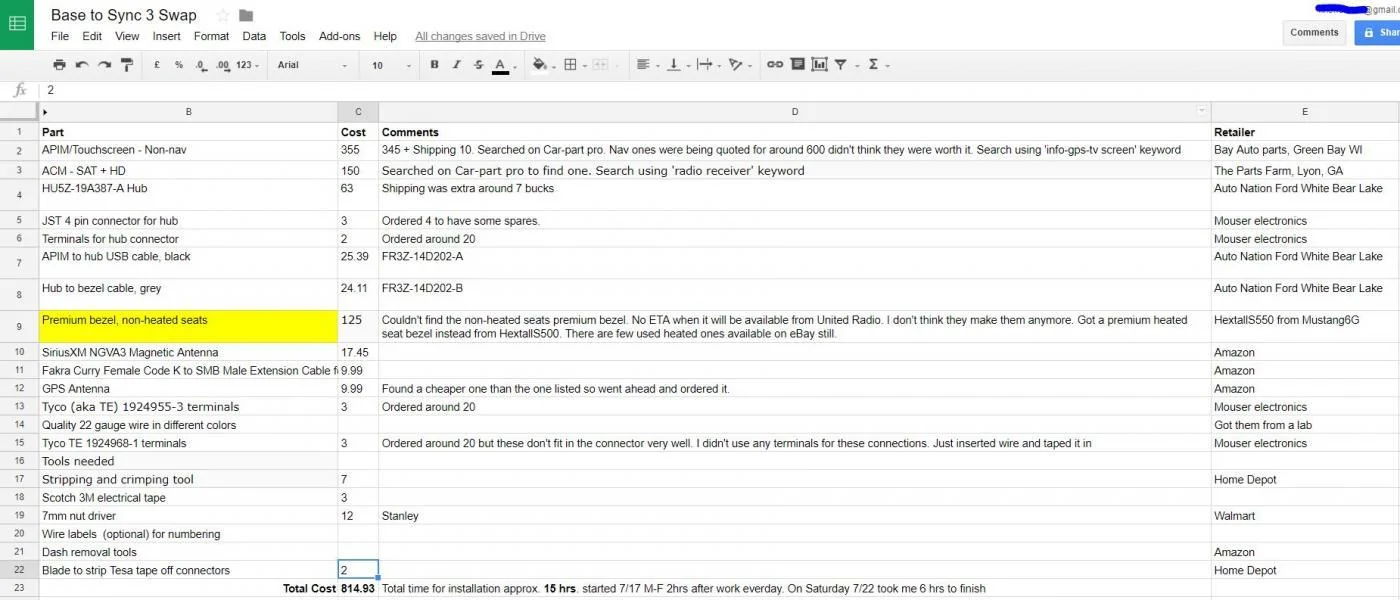

I don't think you read very much of this thread... You would see I'm not sarcastic internet guy. I always ask people that don't understand "why?" in an attempt to fix the issue with the OP.If it would have said If you have a premium with MFT and nav and HD and and H/C seats and want to switch you need x....x....x....x... and the part numbers are here on this single list
I answered your question, but you seem stuck on part numbers. Ford Electronics don't really have part numbers, you can't just walk into a dealer and ask for them by part number. You'll need the VIN (to satisfy the Ford ordering process) and you'll pay out the ass for new or reman electronics (and that's BEFORE the core charge). They have engineering numbers. What you need to do is start searching for the Sync 3 APIM/Touchscreen. Once you have that AND the VIN you can order the rest of the parts I posted.
