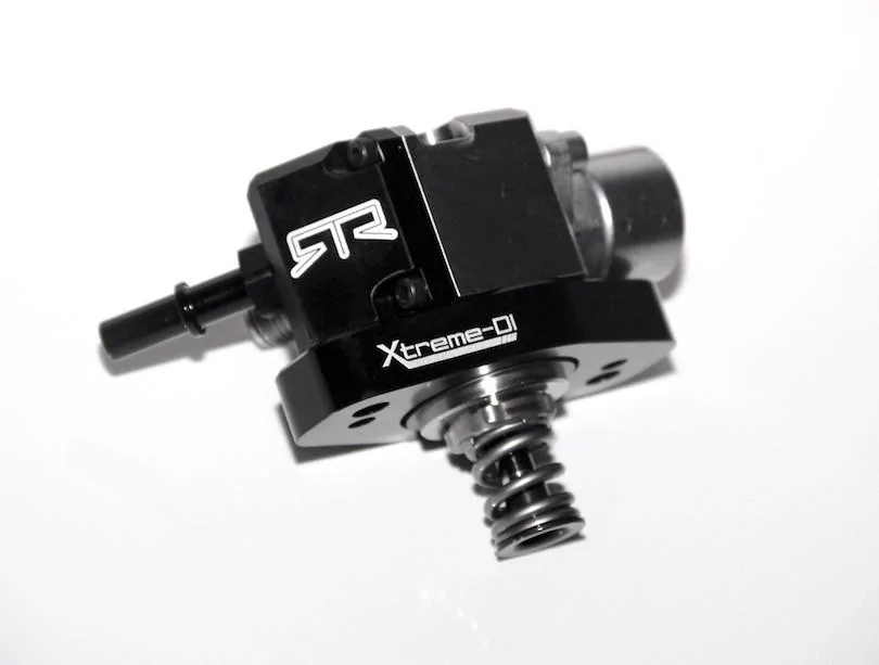

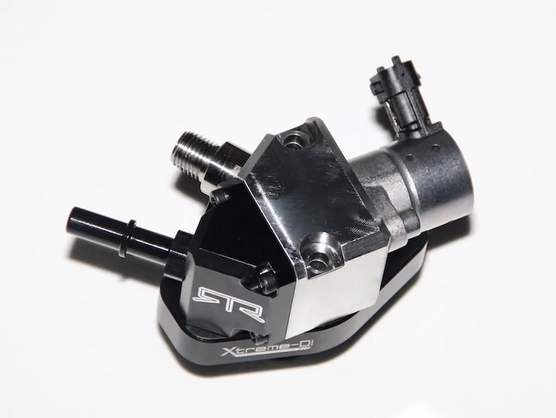

Now that it is public knowledge that this product exist, I am allowed to share some information on it.
Who: Vaughn Gittin Jr and Myself - Vaughn, RTR, and Xtreme-DI are the one's in charge of product development, I was just assigned to do testing with the 2.3L Ecoboost
What: RTR / Xtreme-DI HPFP Upgrade Testing with E85 on 2.3L Ecoboost

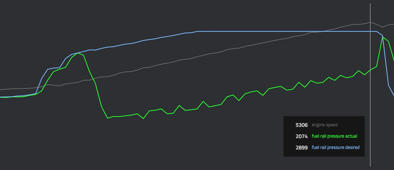

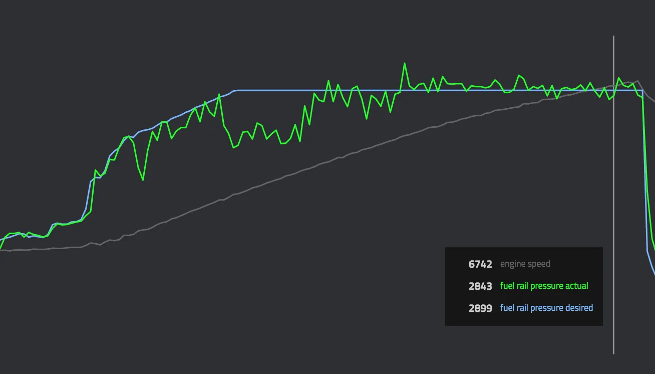

Here are before and after logs (Fuel Rail Pressure) showing where the factory pump fails to keep up with demand, and the RTR/XDI pump shines. The pressure was a little overzealous and we are actually testing around 2400psi now to keep everything happy. This pump has the potential to flow some serious fuel, but is a little overkill for what we were trying to do.
Here is the factory pump on E85:
And here is the RTR/XDI pump on E85:
As you can see the pump has no problem keeping up with desired fuel rail pressure unlike the factory unit. This was from initial testing, unfortunately I only had a day left with the car when I got everything sorted so I had to give the car back. Fuel Rail Pressure actual "jumpiness" was sorted by make a few changes and lowering the desired pressure as it was too much for what we were trying to do.

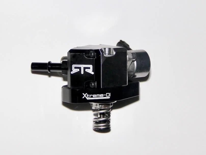

ETA for the Ecoboost Mustang and the Focus RS is January 2017. We are waiting to get some fuel lines made for direct plug and play fitment as the inlet/outlet are reverse in 2.0/2.3 applications.
