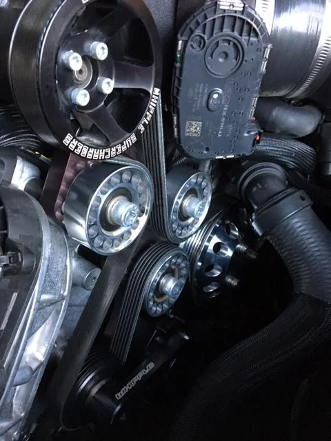

I installed my tensioner today and the noise is gone! Thanks Whipple!

Are you 6 or 10 Rib? I have the belt off the back issue also with my 10-rib. Unfortunately the new tensioner did not help. Only made my belt squeak. Dustin has been excellent to work with. He has new plate spacers/stands coming my way. Hopefully that will fix the issue.
I have the 6 rib set-up. Hope the new plate spacers/stands do the trick for you. Good luck!

put mine in today,nice billet piece
most of the chirp is gone with the old belt,waiting on new belt and hopefully it will be 100% gone

New idler plate stands is the final fix for ones that the tensioner does not resolve 100%. Send me an email and we'll get a set coming your way.
