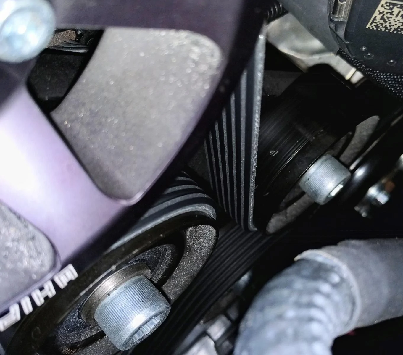

Has anyone gotten the new tensioner yet, by chance?

In my case, the tensioner seems to be too far towards the front of the car, causing the misalignment, so I guess look at any difference in how far forward or back it would sit

Could you post up a pic of your alignment issue ?

It' the same issue brought up by others on here, let me look for those pictures since I am not next to my car at the moment

I found the thread with what seems to be the same issue I'm having, and realized you had already commented on that thread haha, I'll try to get a photo of my exact misalignment asap

It really does seem like if I could just push the tensioner back it would work out, the rest of the alignment seems fine, it's just around the tensioner, at the supercharger pulley, from what I can tell, should be fine

Judging from the picture it looks like then tensioner pulley would have to move towards the radiator as the belt is riding too far back on the idlers.

Yeah it's actually too far towards the back of the car, I thought it was too far forward. At least it does look like everything else would be aligned
