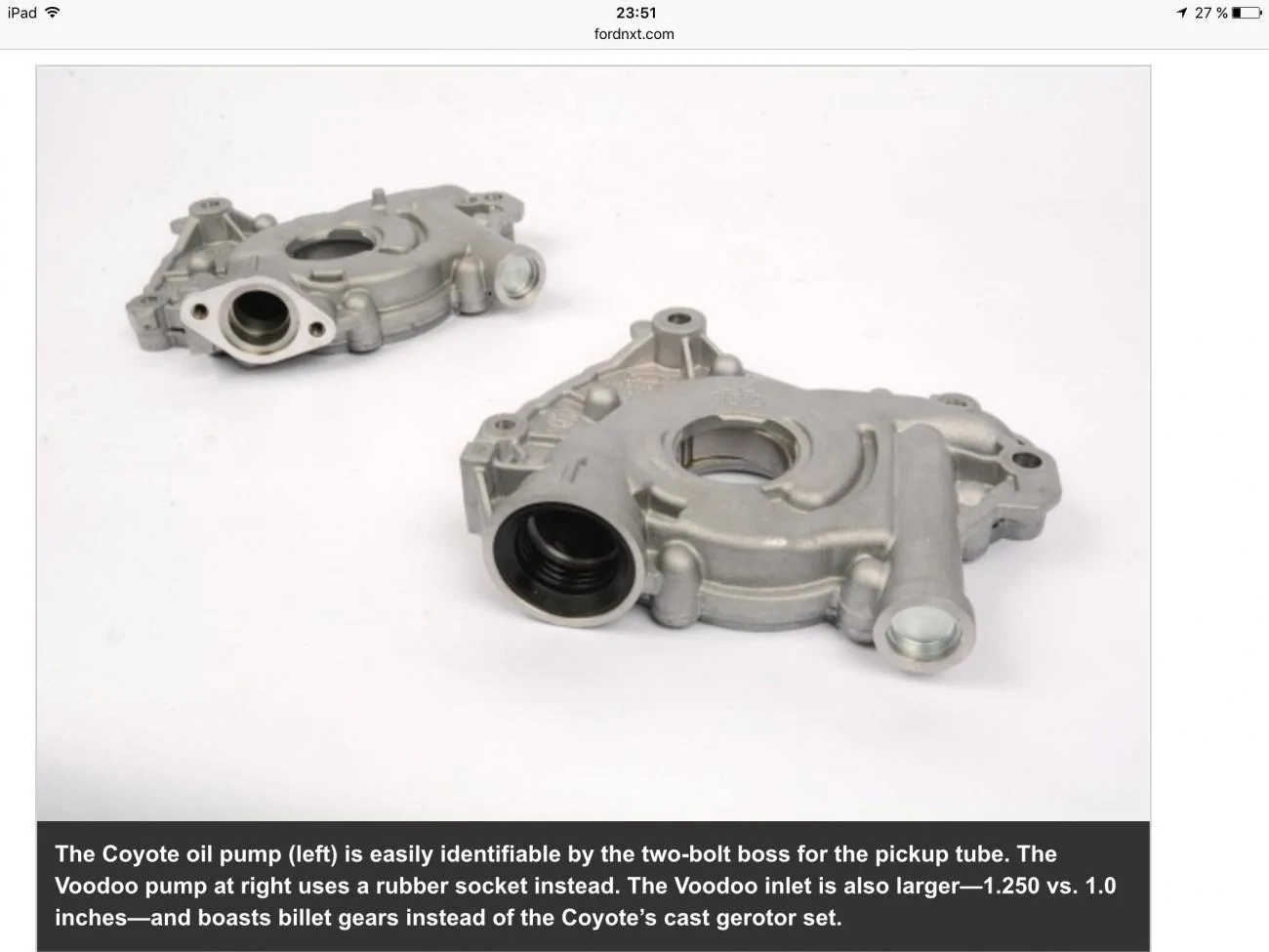

Wrong!About the oil pump gear...I read recently that the GT350 DOES have a billet gear vs the cast piece on the 'Yote. Let me try to find the article.
Looks like they do according to these guys. Hum !!!!Wrong!
Voodoos do NOT have billet gears. I guarantee it.

The voodoos DO NOT HAVE BILLET GEARS. I guarantee it. Call ford performance and ask once.Looks like they do according to these guys. Hum !!!!

The gears are the same as 5.0 gears
Now I wouldn't be surprised if the Voodoo didn't have a billet set. I WOULD be if it did, hence my trying to find the resource to validate.
