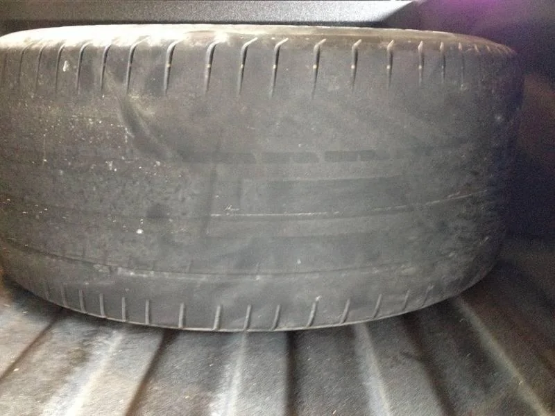

Only 1400 miles so far, but no problems. Just curious. Thsnks!If your right side vs left side tire wear is not comparable, there would definitely be some benefit.
This would typically happen if you either tracked your car on courses that had more turns in one direction that were clearly more abusive than turns in the other, or from street cornering that's much harder in one direction than in the other . . . or possibly from an asymmetry in the alignment settings if your cornerings are pretty well evenly matched (you'd want to get this last cause fixed).
