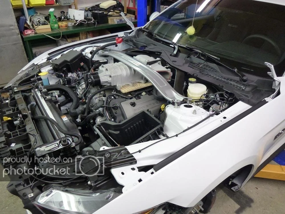

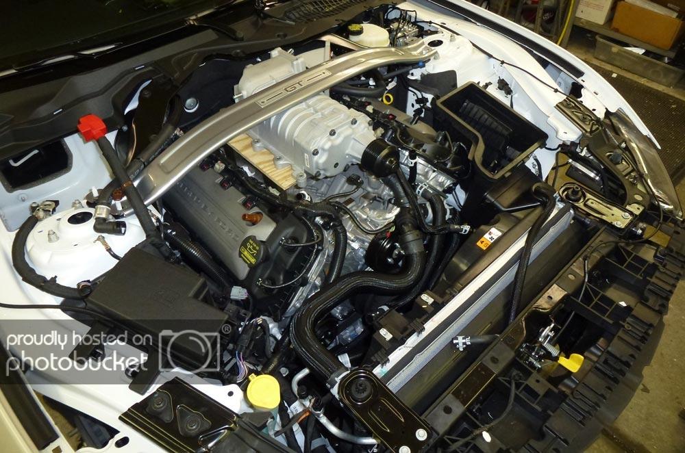

So, that is on the left side, behind the air intake?I pulled that stupid sound tube today on my GT. What a colossal pain in the ass. There is a nut on a stud holding the tube in the firewall. Nearly impossible to get at as it is behind the drivers side cylinder head. I did get it out and plugged the holes. No electrical anything so it didn't throw any codes which is as expected. Honestly if it made any difference in the sound I didn't notice but it sure cleaned up the engine bay on that side. That had a cost Ford a pretty penny. There is three chambers, two could have some kind diaphragm thing going on, three or four rubber sleeves, and a bunch of clamps. Why couldn't they have put that money to better use like making the shiny shit match in the interior.
So that's what that piece is... I was wondering WTF that was, thanks for the lesson.What is the reason for removing the sound tube?
I still wonder why it was removed as well as the Helmholtz Resonator-->:shrug:So that's what that piece is... I was wondering WTF that was, thanks for the lesson.
Any tips or 'gotchas' for removing the front bumper cover?
That sc sure is pretty sitting there. ;)
Thanks for the tips. Does it look like it's possible to release/loosen just the top half in order to pull the headlights out, or does it all have to come off as a I suspect?Lots of screws holding the splitter on use an angled power driver with 7mm socket. There are two 5.5mm head screws near the ends of the front rubber gasket. And one on each end at the fender/bumper cover seam. Then it pops apart and lifts off. Ford did a terrific job with the grills and plastic surround for the fog lights really nice work.
