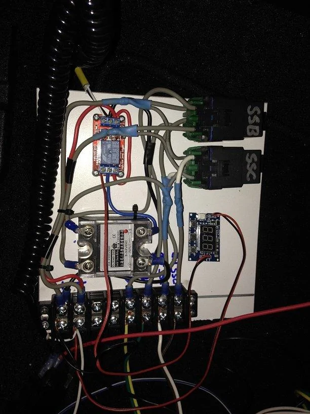

OP OP Eco85 Mad Scientist Joined Oct 6, 2015 Threads 90 Messages 742 Reaction score 209 Location Northwest IN First Name Justin Vehicle(s) 2015 mustang Aug 19, 2017 Thread starter #43 Not sure what happened to the thread? Anyway here is the wiring diagram and parts list 2- relays 2- relay sockets solid state relay part#ssr-40dd one channel relay with optocoupler "ebay" two-way pulse frequency module, square wave "ebay" activation switch trans brake buttin "momentary" bump button "momentary" Attachments 6r80 t brake w bump.pdf 614.4 KB Views: 205

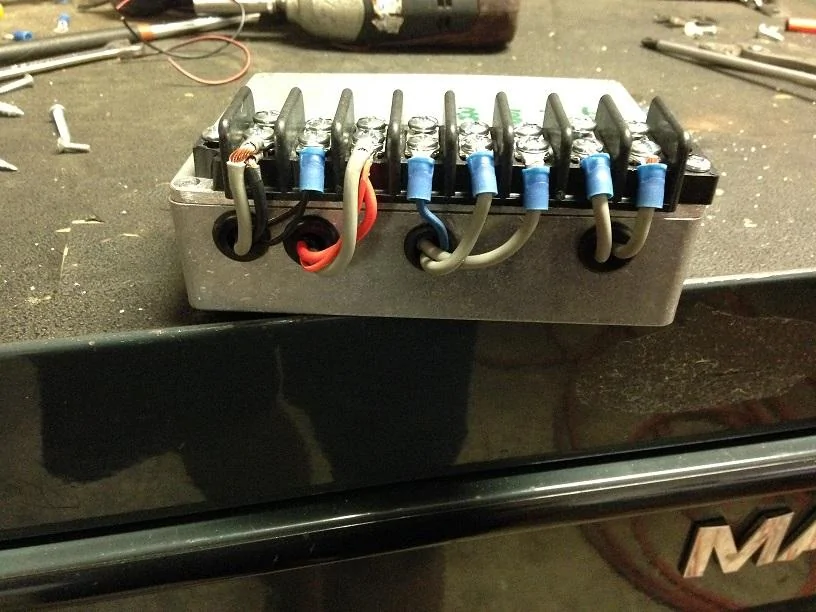

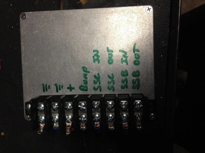

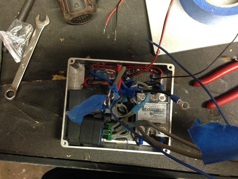

OP OP Eco85 Mad Scientist Joined Oct 6, 2015 Threads 90 Messages 742 Reaction score 209 Location Northwest IN First Name Justin Vehicle(s) 2015 mustang Aug 28, 2017 Thread starter #44 T brake housing So I found an aluminum box it all fits into. Its a guitar pedal box 5x5x2 found it on ebay. part #1590xx :cheers: Sponsored
