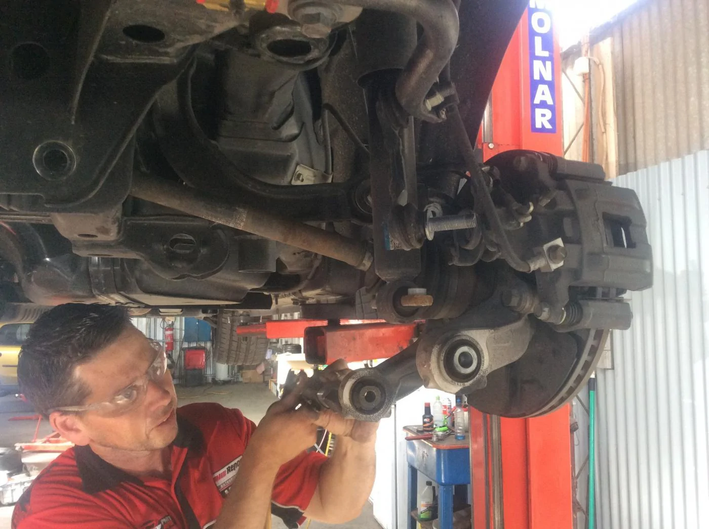

Burkey
Burkey
Feb 9, 2016
87
5,543
3,521
Australia
Dave cutting out the shit-arse factory style toe knuckle bush.
Yes, your rear suspension will look like this if you attempt all of this in one sitting :eyebulge:
I can't believe you had to cut out the bushes, mine came out with very little force and the whole process of replacing them alone wasn't even half an hour to do both sides :shrug:
The bushes make a massive difference all for the better and should seriously be high up on the priority list of suspension mods for anyone else looking at doing the same mods.
I dunno. We weren't using a hydraulic press which might make a difference. We were using a "Repco" press for the LCA bushes. Basically, a bottle jack with trusses so to speak.
We used a bolt driven type for the toe knuckle bushes cos I didn't want to spend even more time taking more parts off the car. It saved us time in the end. Only took a few minutes to cut the bushes with an air driven saw.
