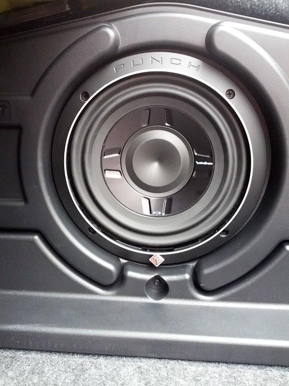

I posted this in the general forum, but it makes more sense here.
I have the 12 speaker shaker with the sub.
Decided the sub needed some help without getting crazy. Did a similar mod on my ST.
So,
Easy install, 3 torx screws at the bottom removes the faceplate, 3 more bolts and the sub is free.
Unplug harness, remove sub.
Remove the grill and unscrew the speaker.
There is one screw in the back holding the magnet. Remove that and the sub falls out.
It's a dual voice coil, so 4 wires.
Plug that hole on that back. I used that foamy 3m tape on both sides.
Purchase:
Rockford Fosgate Punch P3SD2-8
And RF P3S 8" grill
Amazon has both for around $110.
Drop that baby in, button it up and enjoy.
I had a request about the center speaker, so I figured I'd throw in the pic.
Its a Polk DB351, mounted from below the panel for tweeter clearance
Also a tweeter request, Kicker KTS25, removed the pillar, dremeled the stock mount and installed from the front. be SURE to use the supplied crossovers.
