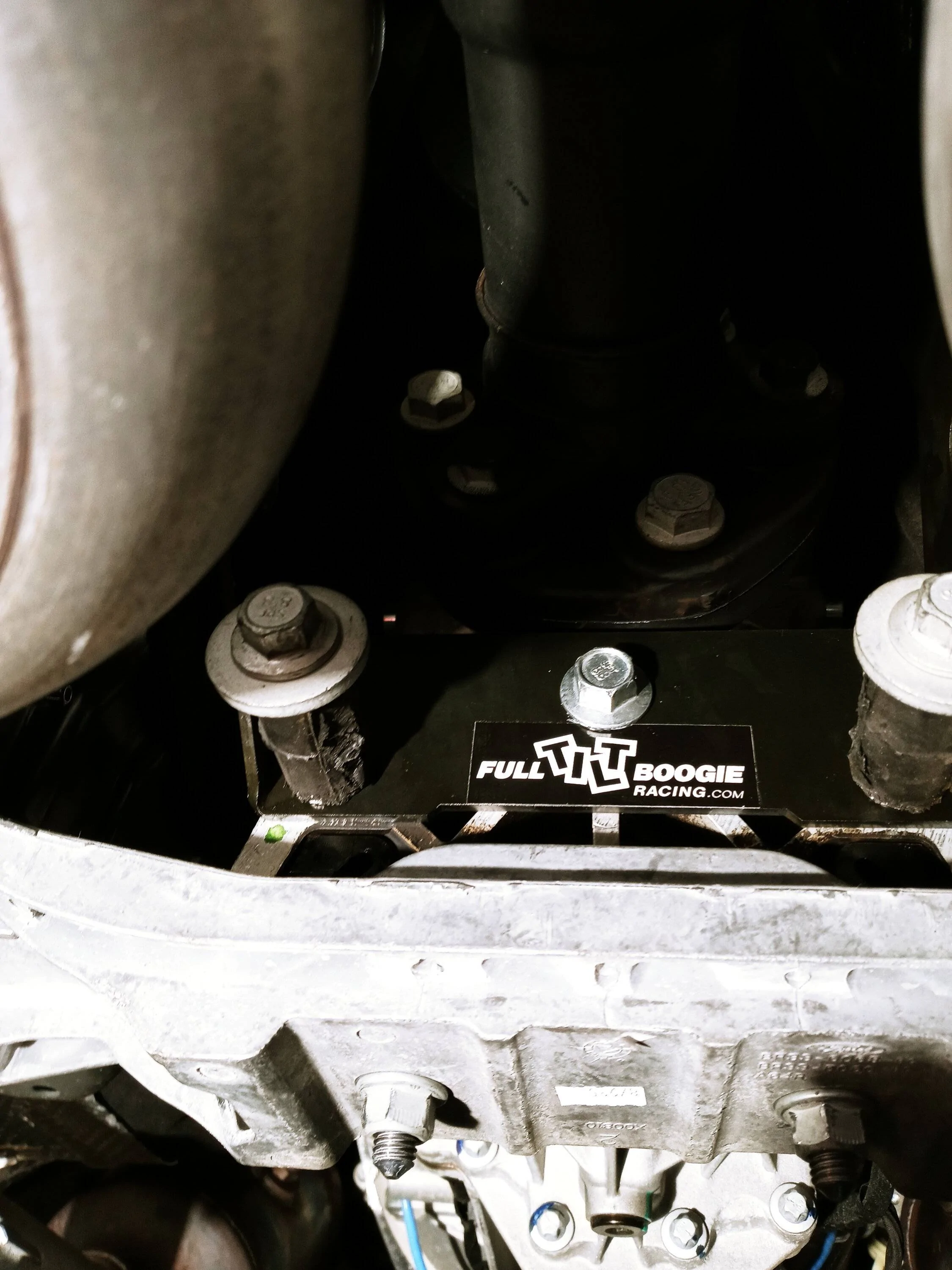

Has anyone tried installing this bracket on a 2018+?
paulm1
Mar 4, 2022
460
559
Northeast PA
pau
2021 GT mustang
Yup, work's great. Installed on my new '21 back in may. You have to lose the NVH bracket attached to the 2 outer trans mount bolts but this is not a big deal IMO. You can source the 2 outer bolts or reuse them if you don't mind cutting up the NVH device. What I did was work the 2 bushings out of the bracket with a vice grip, then cut the plastic and rubber away from the sleeves. This essentially gives you a spacer for the longer bolts and works fine. I also picked up a short throw handle off ebay for $100 bucks and put that in at the same time. I did all the work without dropping the driveshaft or exhaust. I did remove the crossmember just to drop the trans a couple inches. It feels like a top loader now. I love it. And I spent $200, not $600 for one of those MGW overpriced type shifters. And before anybody asks, yes it increases NVH. If you don't want to feel vibrations in a manual trans shifter go buy a BMW.

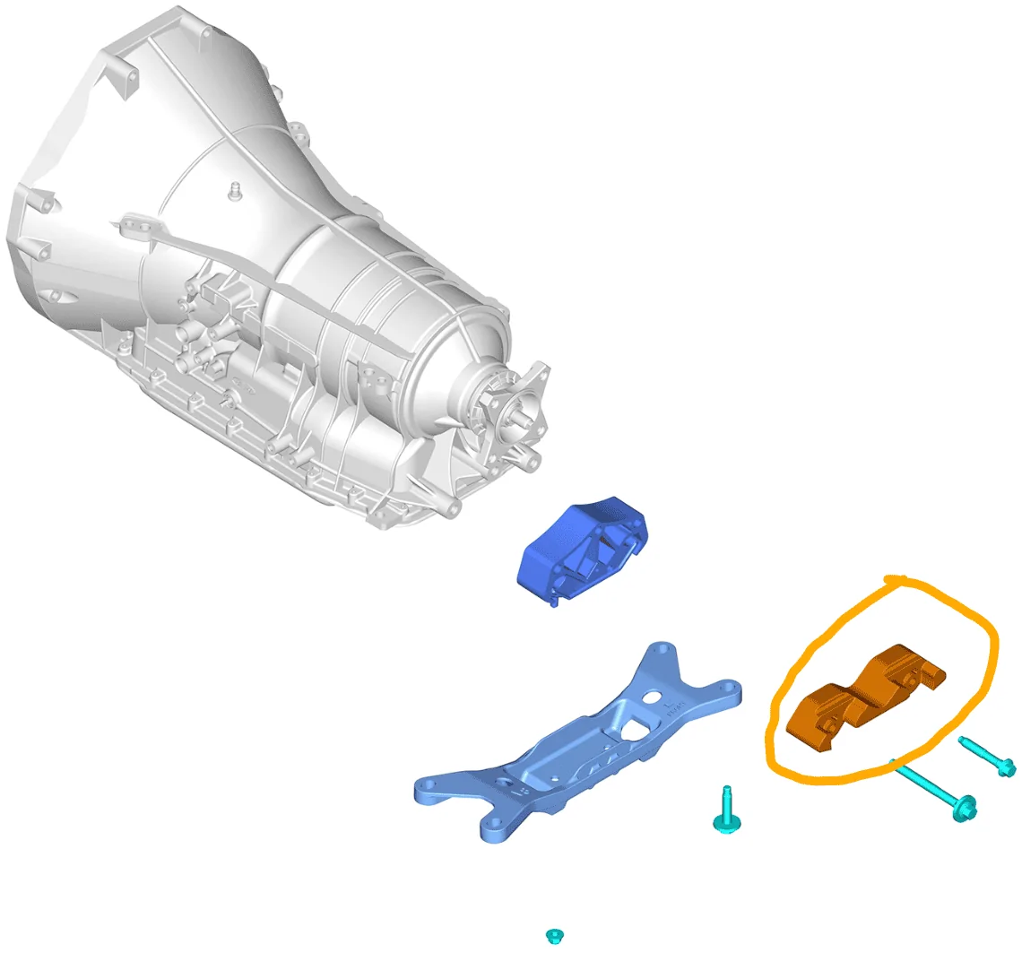

Did you see a way to keep the NVH damper with some modding?
I think the part will simply be a weight to change the natural frequency?
Did you happen to take any photos?
We are talking about this orange thing, right?
JR3Z-4A085-B

you would have to cut up the shifter bracket to keep nvh device. Kind of stupid to do that imo. The increase in nvh is not a big deal, i actually like it a lot more. When i'm wide open at 7500 rpm banging gears i expect to feel the ponies in my right hand.

@paulm1 Thank you!
You are right, I am thinking about cutting up the nvh damper. 🤔 😂
(I fully understand that the properties of this part are largely determined by its weight and how stiff it is connected to the part being damped. Cutting it out for the holder can also have negative effects.)
