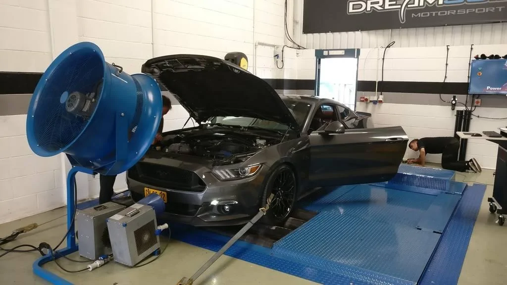

Dyno: Mustang @ DreamScience in Hull

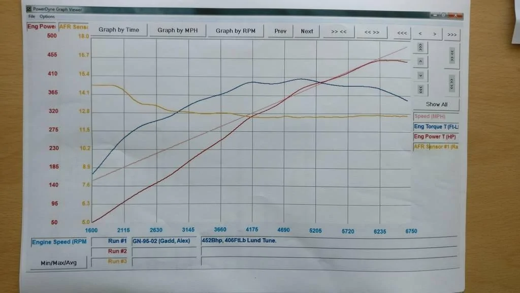

So, folks. I finally made it to a dyno. Mods on the car are as above, 20k miles on it.
We all know different dynos make different numbers on different days etc etc. DreamScience's dyno is a 'Mustang Dyno' (handy/confusing name, eh), which is agreed to be a 'sad' dyno or a heartbreaker. i.e. no BS sky high numbers.
Apparently a std. UK GT will dyno at 405-410bhp on this machine.
My numbers are: 452bhp / 550Nm (406lb ft). Interestingly and rather surprisingly it made more power with the exhaust valves closed; 452 Vs 449!
Ill be honest, I was hoping for more (i.e 470+). The good news is that its a very, very safe and smooth tune. My next step is to email LUND with the results to see if we can get a bit more aggressive with the timing.
So, might be handy for some of you to see. This is a no BS run on a good dyno.
