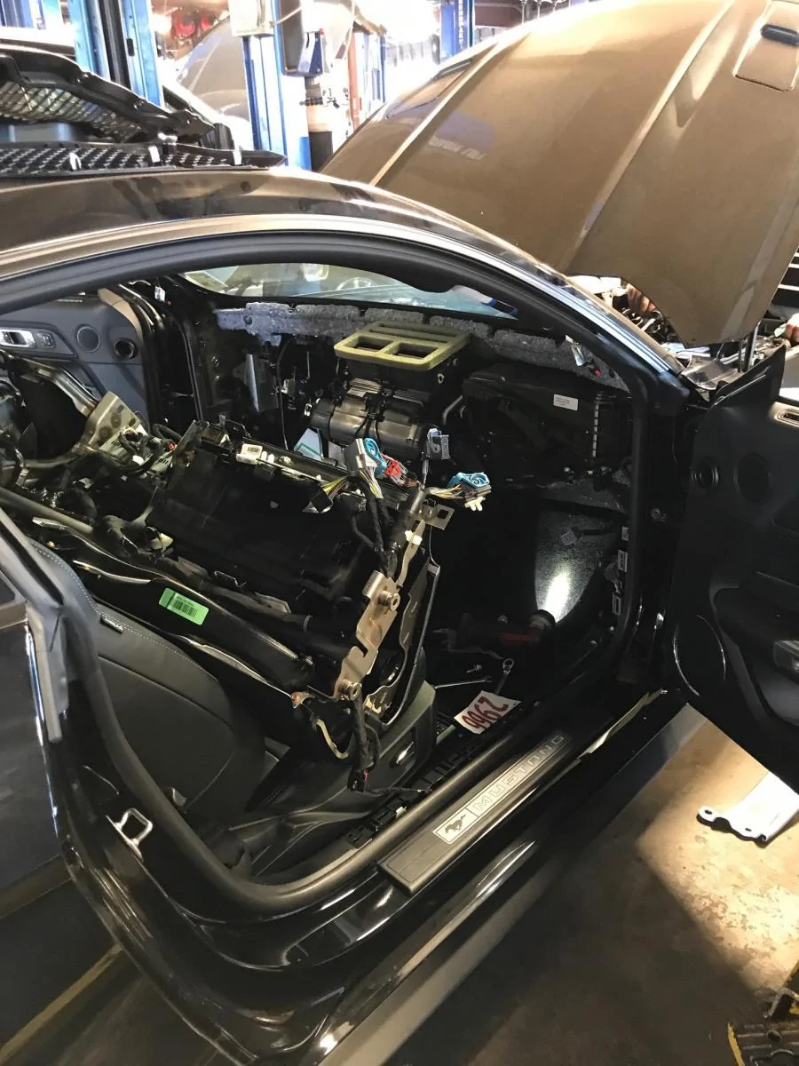

My AC failed yesterday... during the Hunter valley drive.
Luckily its winter and windows down was comfortable.....if it happened the last time we drove putty road, it was like 44 degrees.... thankful that the aircon was working that day! was a very comfortable place to be.
anyway.... last week I had the (i assume) compressor making noise on cold starts, would whine and increase with engine revs.
Turn the AC off and the noise would go away.
But now its stopped blowing cold air.
It is still blowing air (hot) through the vents, at all temperature settings.
no smell of refrigerant or the white snow/powder stuff blowing out of the vents that some report.
So heres hoping its just the compressor that has packed it in and not the evaporator core. As (i think) that is a much more straight forward replacement!
Has anyone in Aus actually had the evaporator core replaced?
I'm waiting for Dominelli to get some practice in pulling the dash out before I run the gauntlet.
Let me know once you've been and I'll book mine in.
:thumbsup:
:thumbsup:
:paddle: I shal be very careful to outline how much I dislike damage to my vehicle.
But again..... what i have experienced sounds like a compressor/bearing issue. Hopefully not the pull the dash out of my car issue.
Mine was built around the same time as you Rob so no doubt mine will pack it in soon enough. Drew you're first :lol:
Been reading up some of the relevant threads..... sounds like even the replacement parts have a high failure rate, and they have been using a few different replacement part numbers...(this is in the USA) so i dunno, it is what it is. just want it fixed.
