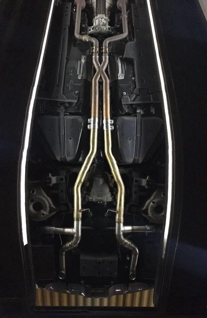

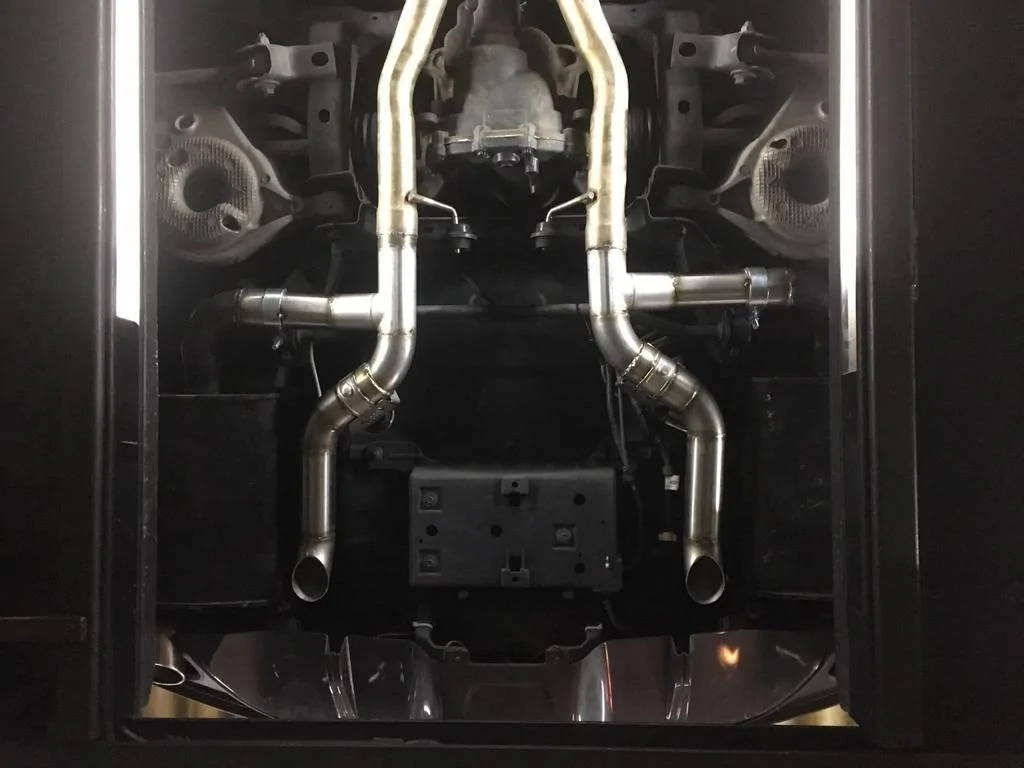

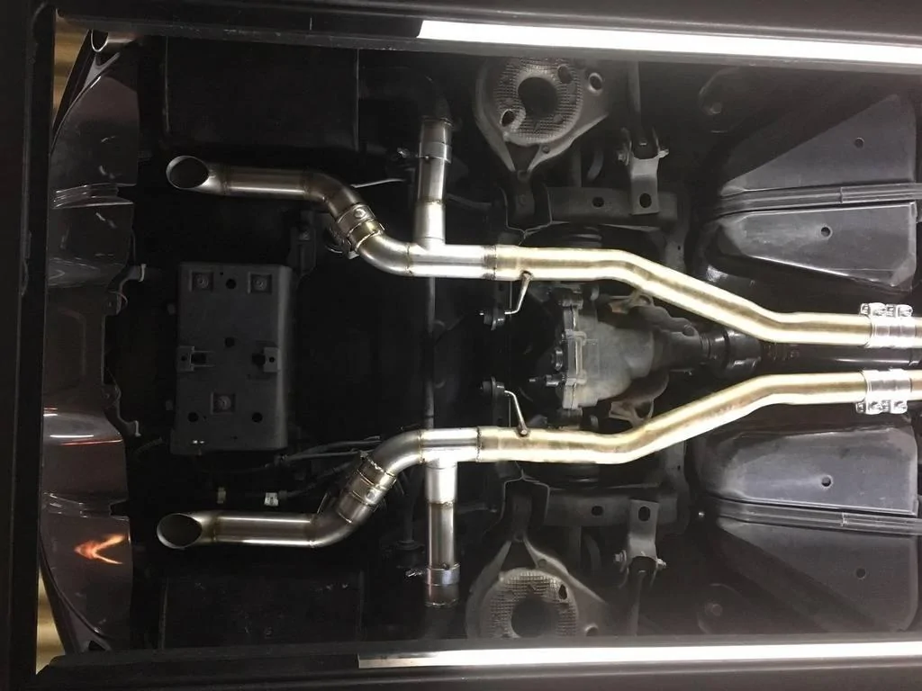

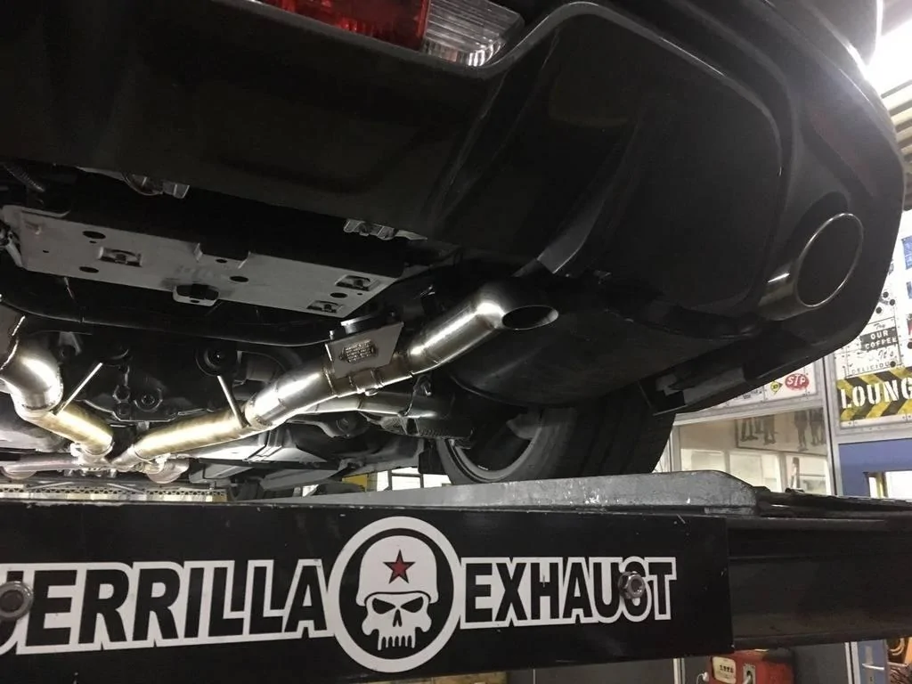

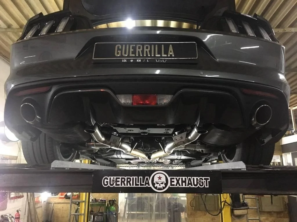

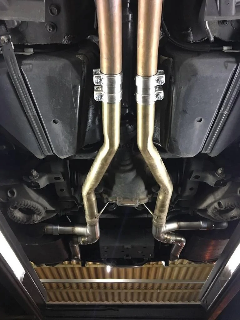

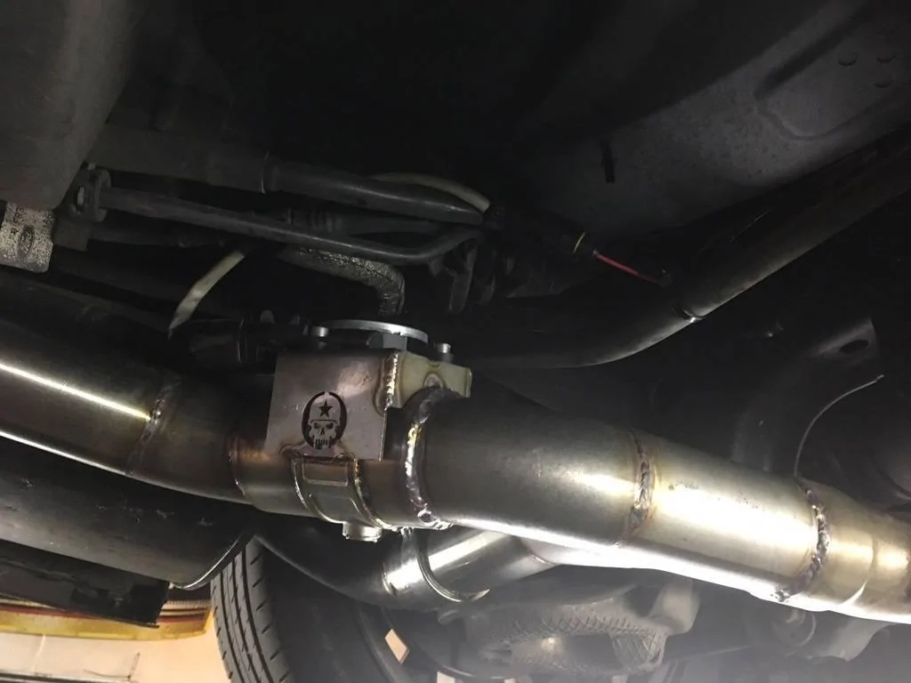

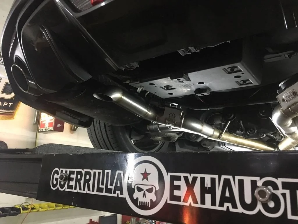

Custom valved exhaust system. Unique to me. Designed, manufactured and installed here in NL. Its epic!

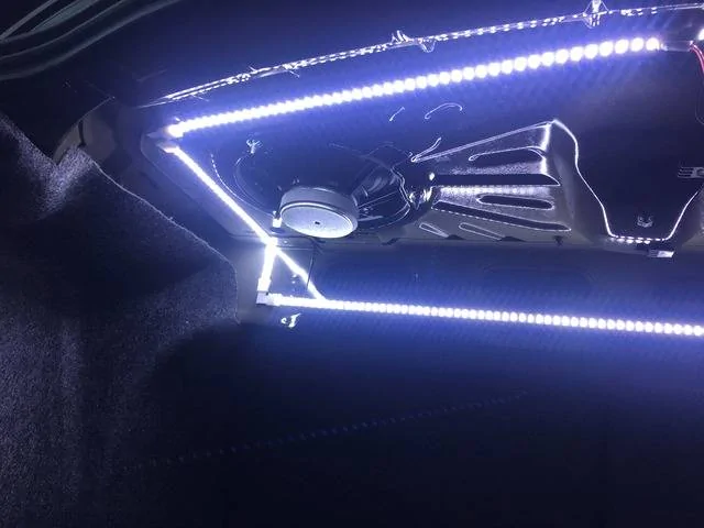

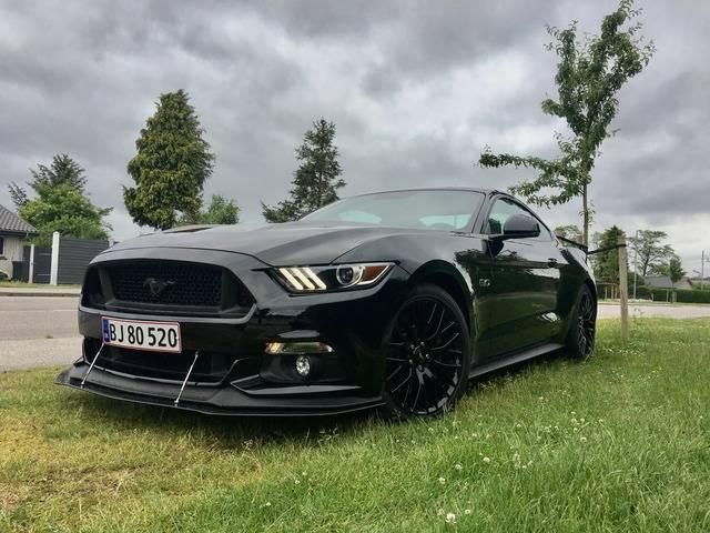

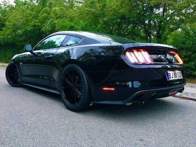

Been pretty busy these past few weeks. But finally had some time to work on my car. The front looks way more aggresive with the APR front splitter, lower US GT grill and black pony.
Installed the DD LEDs inside the car, and put a LEDstrip in the trunk, and it is fucking bright. :eyebulge:

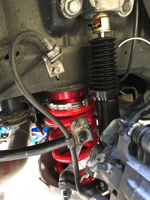

Also put in my Pedders Extreme XA Coilovers. Pretty easy install even with jack and jackstands. Think I have about 1,5" drop in the front. A little less in the rear. Started with 20mm drop rears, but had some tirerubbing on the black plastic part of the wheelwell. Raised it 5 mm two times, and now it don't rub when going over speedbumps.
20x10 squared Niche Misanos wrapped in Michelin Pilot Sport 4S. 275 front, 295 rear. I think the car looks pretty good now. Also had the car Opti-Coat Pro done. Could be the best 1000 Euros I've spend on this project. Way easier to keep clean now. I asked PJ for a flush fitment, and I can honestly say that he delivered. This is as flush as it can get. :D

Nice Johnny :) but havent you installed the eibach? Or you just thought about it?
John577
John577
Mar 28, 2015
2,672
906
FRANCE
2015 Oxford White Fastback Mustang GT
Yes, I thought about them but finally went for the KW's in 30/30 as Eibach is only 25/20. The look in 30/30 is so much better :cheers:
Sounds great. Best mod ever! :headbang:
This will be my first mod when I buy my 2021 GT! Where did you install them, is there a link? And what is it exactly, did you use the stock exhausts and connected the internal unmuffled exhausts in parallel?

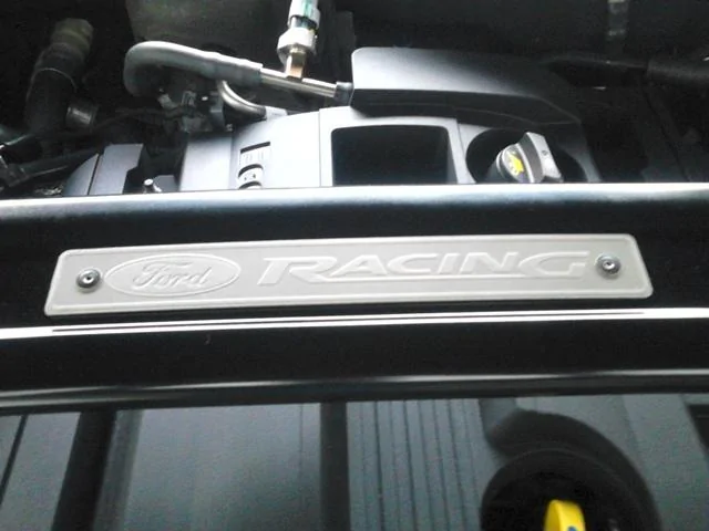

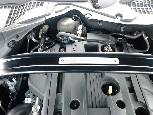

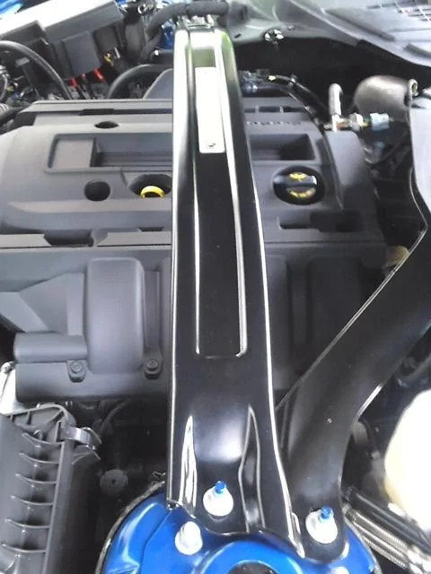

Ford Performance Tower Brace Strut
Tower Brace Strut makes a noticable difference in maneuvering curves at higher speeds. Steering is tighter and less body roll. Looks cool too. :cool:
