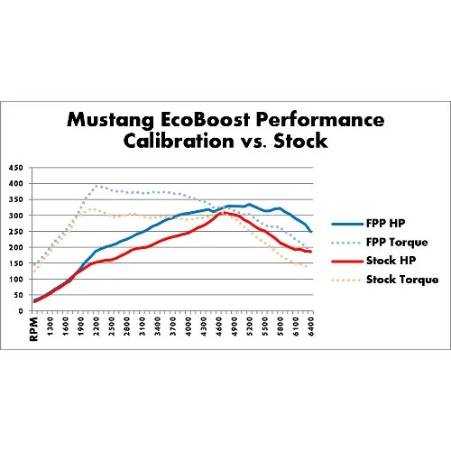

I spoke with Mike Goodwin at Ford Performance regarding the sudden torque drop off at the top end. He confirmed that's simply the PCM protecting the catalytic converter:
It definitely looks like you’re getting into cat protection zone above 5800 rpm. Heat tends to build up in the cats on repeated dyno pulls as there is no air moving under the car to keep them cool. A run with the cats starting completely cool would probably eliminate the graphs falling off.
The latest version of the calibration should fix your dips in the 5000-5300 area on your graph.
Mike Goodwin
Supervisor Ford Performance Information Center
As noted however, there's one MORE limitation of the typical dyno. You simply don't get the air flow you need through the engine compartment and the necessary cooling to see the full power. The top end will pull stronger than the dyno would indicate in actual use (which is what I experience) as the catalytic converter is cooled by air moving through the engine bay and around the whole exhaust at speed. Many of these after market tunes simply disable the protection function for the catalytic converter to get more power.
Problem is if you burn up the cat and your in an e-check state / county, you'll be buying a new catalyst even when flashing back to stock...even worse, it's possible to crack a ceramic cat with over temperature and cause a blockage which would trash the engine. That was an issue periodically with bad catalyst designs even on stock NA engines, I recall that being a problem with 2001 Chevy Impala's (had an old 9C1 police interceptor back in college, named Helga) and that was a common issue with the stock cats cracking after 100k and trashing the exhaust side valves due to massive blockage.
The only items that get air flow on the dyno typically are the inter cooler and to some degree the radiator, but even that's limited. Beyond that there's no air flow under the car, so you can either disable the protection functions in the software and just over heat it to make maximum power, or you can leave them on and find a way to provide cooling to get a better approximation of how much power you could potentially make under real driving conditions by providing air flow to the cat.
This would be one more reason to use a tuner with a close relationship to the parent company (Ford) from a reliability standpoint because the level of testing needed to make maximum power without sacrificing engine life is beyond what most of your typical shops can do or are willing to do. For any street car, reliability shouldn't be sacrificed for the sake of a few extra ponies.
The next dyno run I do with the ATM inter cooler I'm going to see if we can stick one of those squirrel cage fans under the car and blow air on the catalytic converter and see if that provides enough cooling to let the top end stretch its legs with the FP calibration.
