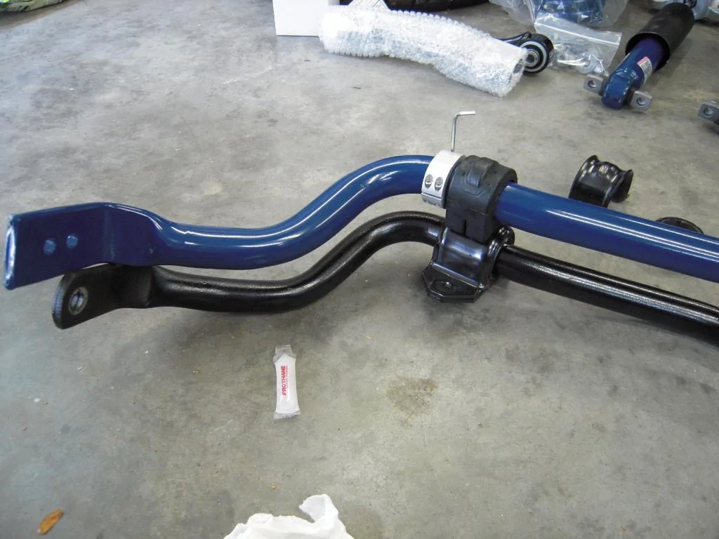

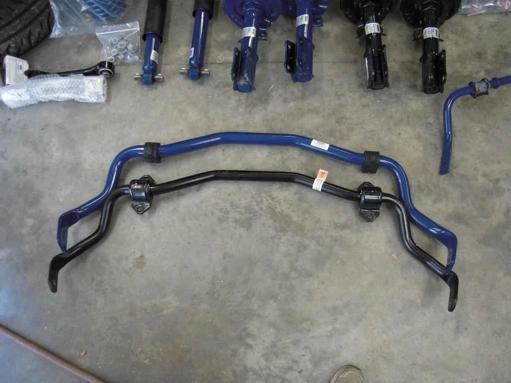

If you look at the contour of the bar, I'm guessing Ford doesn't think it needs locks because there's quite a bit of "bend" in the bar to slow/stop movement already. (Track pack bar is blue, stock GT PP bar is black)

The bar will never move laterally. The lockouts are unnecessary.
