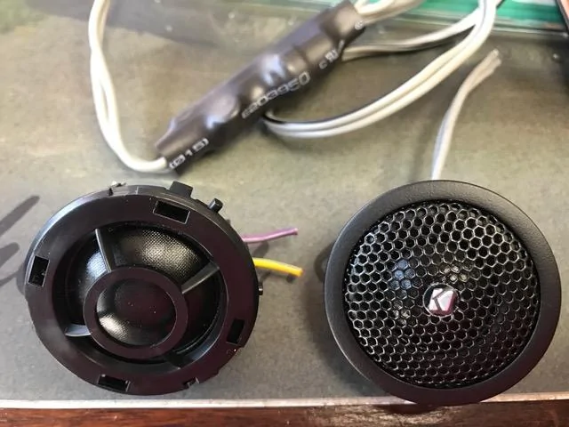

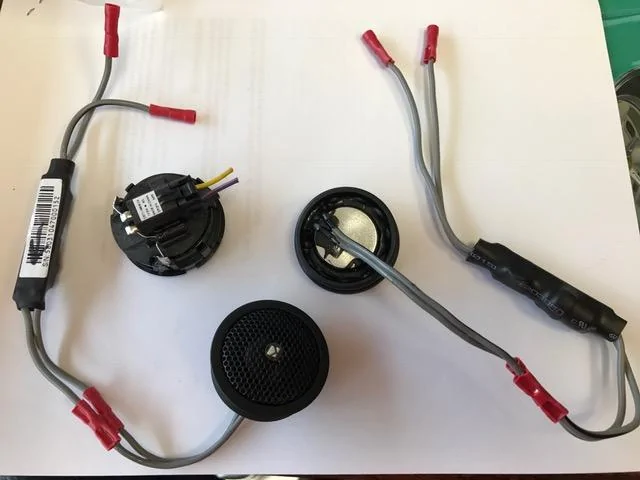

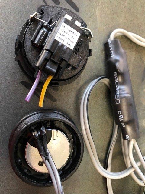

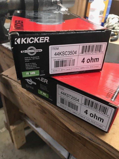

My OEM 400A (9-speaker) 6.5" speakers had poly cones with no tweeters at all - both in the front doors and identically on the rear deck. These may well be the same drivers in the base car? Anyway, my rears had very little treble as well. Now with the Kicker Coax's back there, the rear fill is full range low to high. So, in this case I think that lack of treble from the rear for 300A and 400A cars is due to Ford's speaker selection and not due to lack of a full range signal back there. Having just done my retrofit, you may consider a pair of Kicker coax's for the rear, either another pair for your doors, or consider a dedicated woofer for the lower doors and- perhaps to start - leave the OEM Tweeter in place in the A-pillar. I was surprised to see how close the factory 0.75" tweeter looked to its Kicker replacement. As delivered with the OEM 9-speaker setup, I had my midrange, balance and fade at zero, treble at -2 and bass at +3.Well, it seems no one is interested in helping me upgrade my base 6 speaker stereo, but I learned something today that may be helpful to others.
