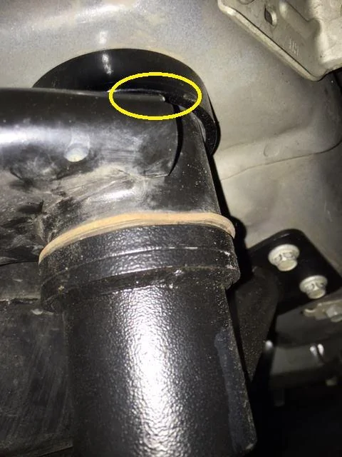

"I have a squeak or creak with your CB005"
It is not "too" uncommon to occasionally have some odd noises that were masked by the OEM components, poke their ugly head once doing the CB005 or other components (from any company) that mount chassis and suspension components more rigidly.
To date, the only time I have had a report of an actual noise being emitted from our CB005, is when they are either installed improperly OR have a rear cradle that does not match the manufacturing tolerance of the cars we have here. I have only learned about this somewhat recently, when pulling my hair out trying to resolve a friend of mine's issue he was having.
I have come to find out, the welds and the positions on the frame to bushing cups on the cradles can be somewhat "off" OR inconsistent. The first picture below shows the area I am speaking of. The BMR Lockout Ring can interfere with the welds on the cradle. If this happens it can cause the assembly not to sit as it is intended to, and can cause noises. The solution at this time is to mark the BMR ring, grind some clearance into the ring and position it / ensure it is flat and non-interfering with the cradle.

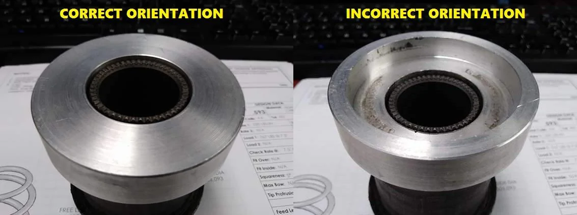

The other issue I have seen is when people install the upper lockout rings like pictured below (upside down). Seems like the impossible, but it happens..

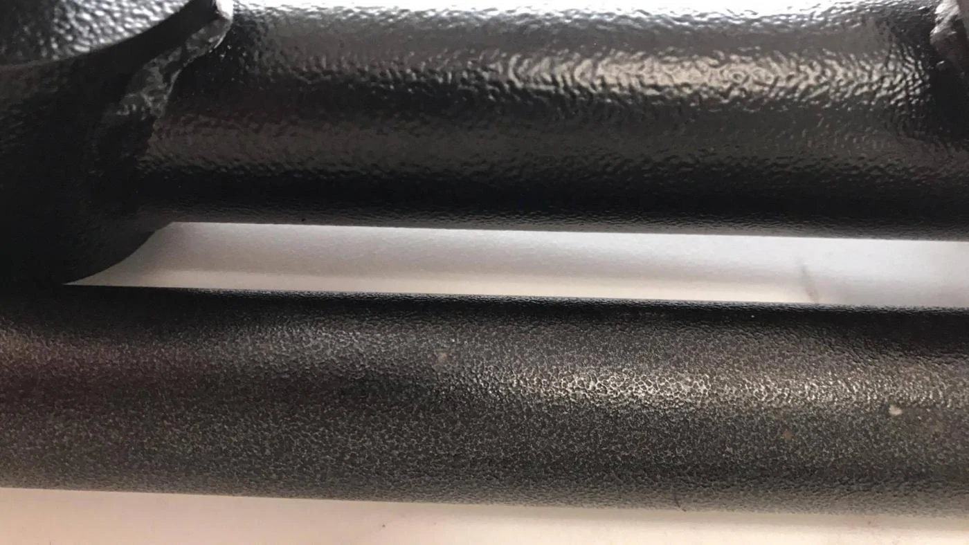

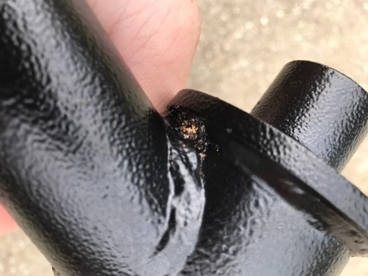

BUYERS BEWARE!
BUYERS BEWARE!
It has come to my attention that there may be a company selling counterfeit BMR products on eBay and possibly through other outlets.
We have received the CB005 from the seller on eBay, and I am very certain these components are counterfeit and not authentic BMR manufactured components.
The seller on eBay is "SoCalPartsDirect"
https://www.ebay.com/sch/socalpartsdirect/m.html?_trksid=p3692
You will also see various "Steeda" products, and also unauthorized reproductions / copies of products like Steeda's IRS Brace and the Fays 2 Brand Watts Link Kit.
I believe this to be their actual web-site: (not 100% certain)
https://squareup.com/store/socalponyparts/
Please be advised, BMR will in no way warranty or provide product support with these items. If you do not have proof of direct purchase, OR we cannot trace your purchase through one of our authorized resellers we will not support your needs related to these items, unfortunately.
