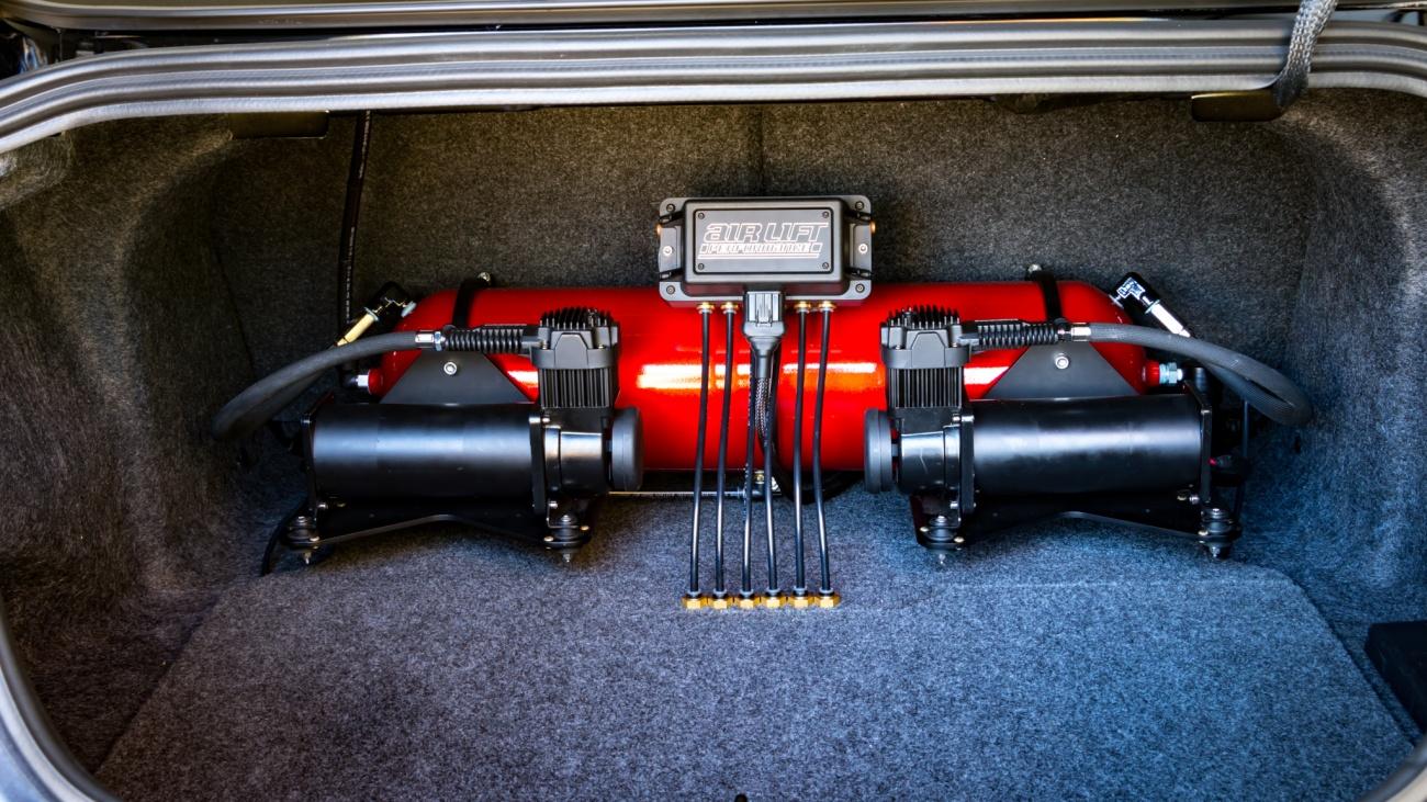

After a year and a half riding around with the raw aluminum tank. I finally got it powder coated and cleaned up the air lines. Thanks goes to stang_inang_yan for the inspiration to use bulkhead ptc fittings.
I just need to clean it all up and get the finger prints off of it.
Airlift 3P controller
Specialty Suspension tank custom powder coated
Viair 444c compressors
Accuair EXO mounts with custom made bracket for 3P controller
Fittings from Bagriders
Custom made mount
Zero holes drilled installation

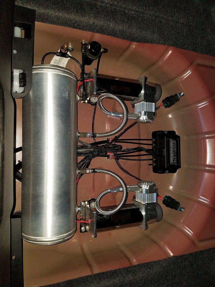

For those mounting the compressors on the side did you have to trim the mounting feet? I can't get them to fit that way so thinking of just mounting the compressors to the side walls of the spare tire well. Will that location work you think?

Yes. Jameo goes through this process in his thread.

Thanks, I don't know how I've never seen that thread with all the searching I've been doing. Getting it installed early next week but would like to mock up the trunk set-up beforehand to give them an idea how I want everything mounted.

Just make sure the drain plug is facing down, or you won't be able to get the water out of the tank.

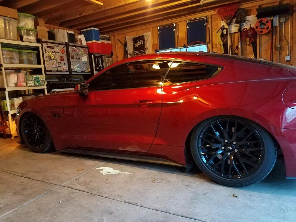

I want to thank everyone for the inspiration and for tolerating my noob questions, I'm sure there will be more. Today I picked her up from install and then promptly slammed her down. Need to do a firmware update to get the controller and bluetooth to work (currently shows 1.1.0 and a "Failure: Incompatible revision" message) so doing manually for now. Hope to get some pics all cleaned up in the sunshine soon.
