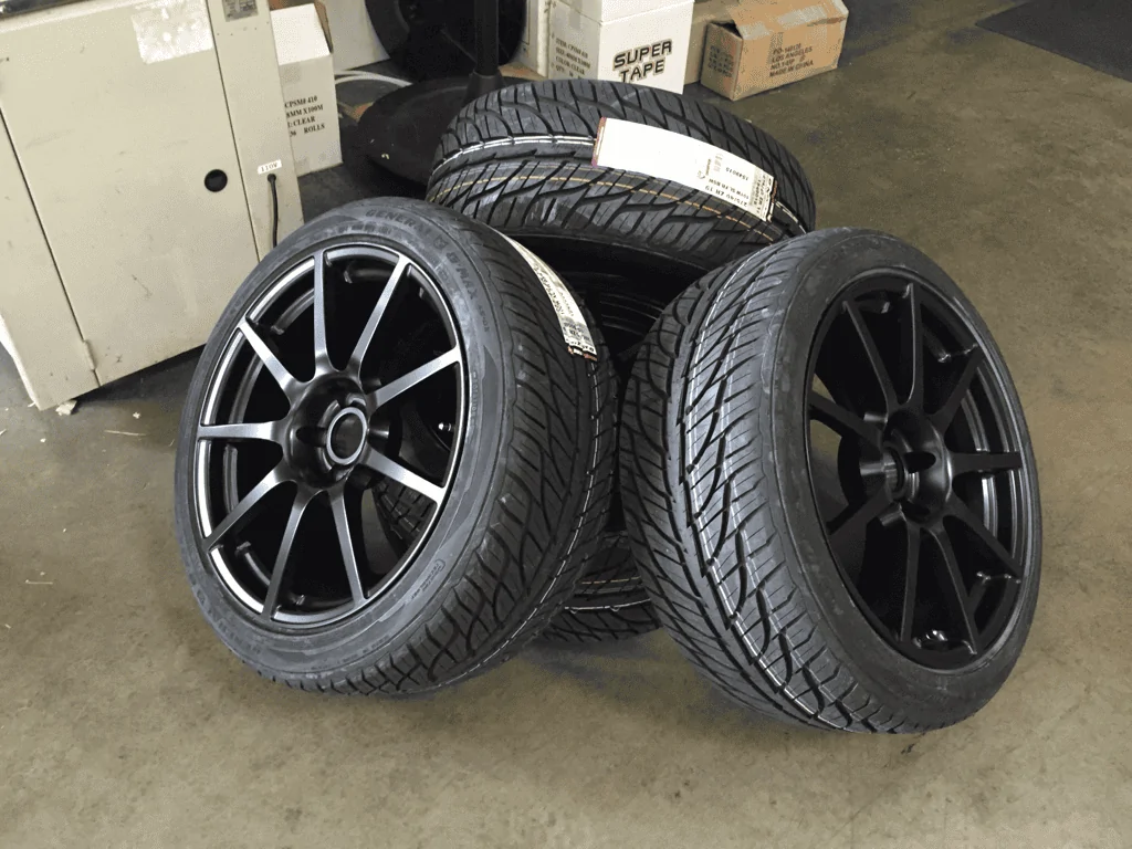

It depends on what offset they are. Theres a chance they'll bolt on, but they will most likely fit sunken in in the front since the 2015 runs a lower offset in the fronts.Hello I have the gunmetal Forgestar F14 18x9.5 front Rear 18x 10 they were on a GT 2014 PP fit with Bremos. The qu es tin I have is will they fit the new 2015 Bremos since the brakes are larger I think? My 2014 was totaled last February so sad but now hopefully new car with new shoes ready haha
bolt pattern 5x4.5" (5x114.3mm)It depends on what offset they are. Theres a chance they'll bolt on, but they will most likely fit sunken in in the front since the 2015 runs a lower offset in the fronts.
The 18" F14s wont fit on a GT PP, but if you have the non PP brakes it sounds like it'll work. Although the front will be sunken in a bitbolt pattern 5x4.5" (5x114.3mm)
offsets +35mm (1.4") +42mm (1.7")
back spacing6.4" (163mm) 7.1" (181mm)
fronts 18x9 rear 18x10 hoping they squeeze on maybe someone could tell me?
Well guess I need to sell these then bummer
Dang it well that's a bummer I ordered the bremos pack guess it's time to sell.The 18" F14s wont fit on a GT PP, but if you have the non PP brakes it sounds like it'll work. Although the front will be sunken in a bit
Ahhh thats a bummer, but I can help you out with a properly fitting set of F14s for your S550 when it arrivesDang it well that's a bummer I ordered the bremos pack guess it's time to sell.
