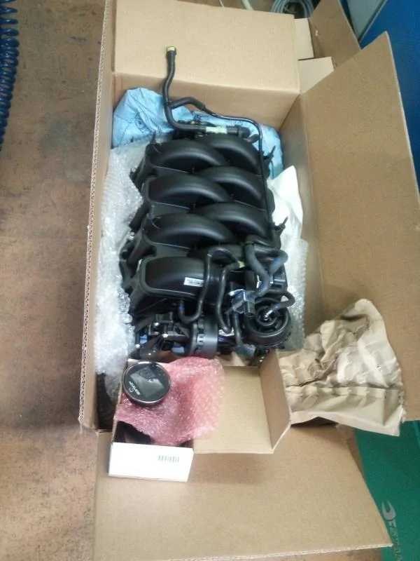

Parts:
This where I hooked up - I reused the stock one way valve and hose - leftover from my GT350 mani install. I need to buy some fittings to make in nicer - peanuts :)
Routing the hose form engine bay to the rear was a PITA - the most difficult part was around the rear cradle - you really need to have a small hands!
Charcoal emission canister is where I placed the vacuum solenoid:
This way I ended with 4 flaps and 8 adjustable exhaust note levels :headbang:
Now that thing is loud and sounds like a Lambo :headbang:
