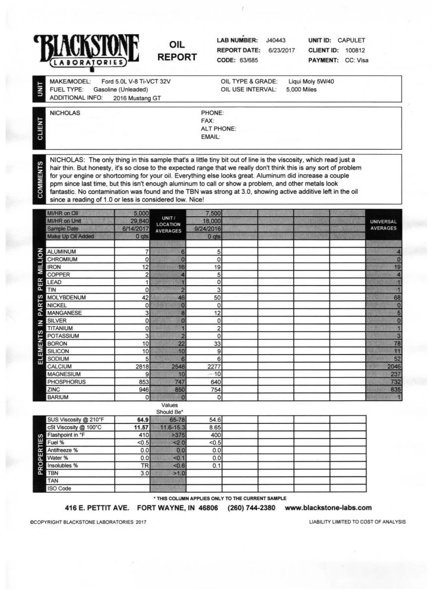

Second oil analysis. Liqui Moly 5W40 synthetic over ~5,000 miles and 4 track days (car said oil life was 53%, if I remember correctly... for sure just over 50%).

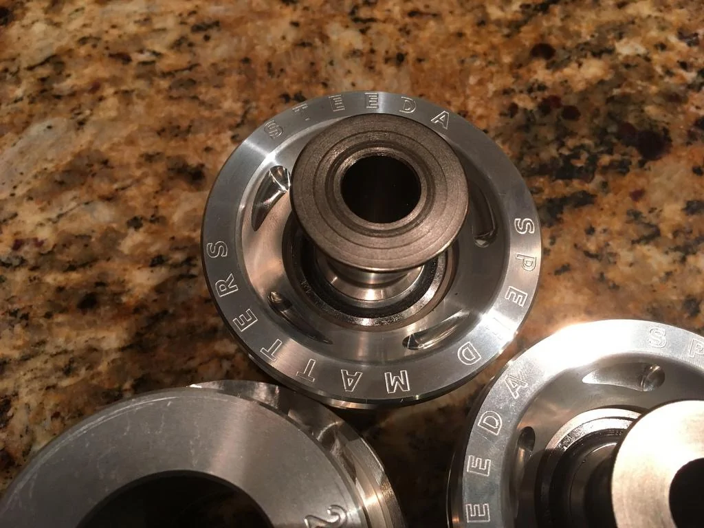

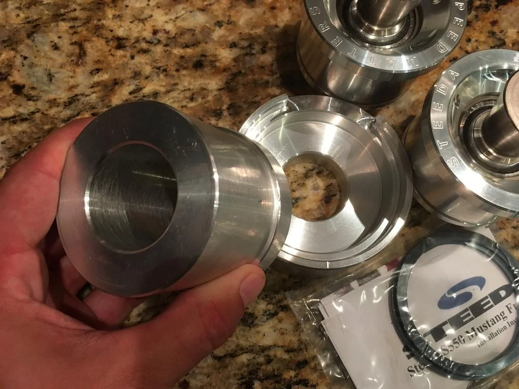

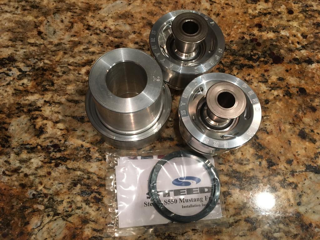

Well look at what came in the FedEx truck today! I'll probably install them this weekend since I'll be test-fitting my 11" / 305 NT01 square setup in preparation for going to Charlotte Motor Speedway's ROVAL and, soon after, Gridlife at Road Atlanta. Steeda provided really nice installation tools suitable for a shop press, as well.
Steeda Front Control Arm Bearing Kit (555-4128)

^^^ interested to hear your feedback on these
Couldn't find the time to install them prior to my Charlotte Motor Speedway HPDE but I'll get them in there before Gridelife (I hope). Anywho...
