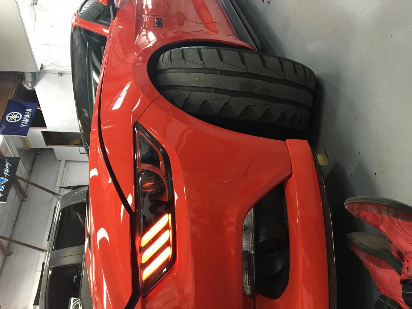

Finally got mine installed today. Still have to figure out to have the running led lights to turn on w out me using the remote all the time to turn it on and off. And can I use an app on my phone as well?
Thanks so much.
