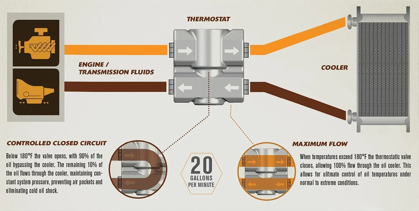

Does any one have any suggestions, apart controlling the pump of the switch, how to activate the pump on predetermined temp. The only item I found is a inline fitting from Delare. https://static.summitracing.com/global/images/prod/large/der-35020.jpg?rep=False
According to reviews on Amazon. It doesn't seam that it works all the time. Apart from drilling the case, like tony did, or Weldon pump is there any other solution. Thanks.
