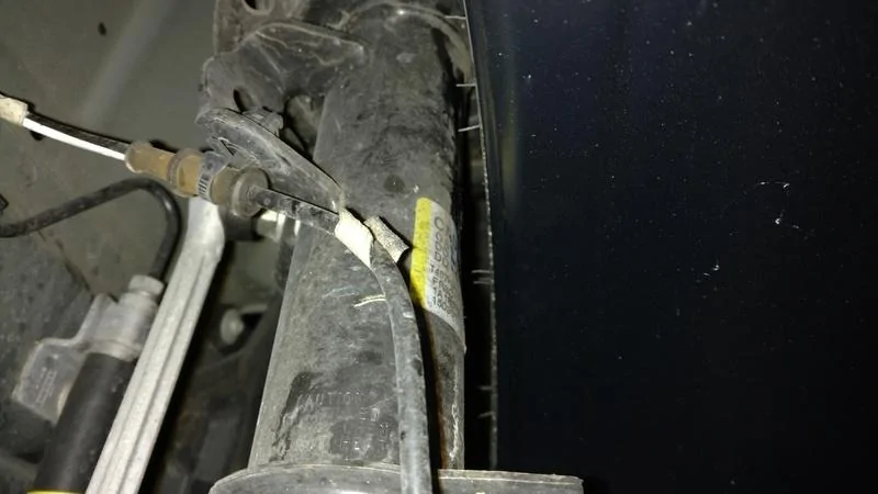

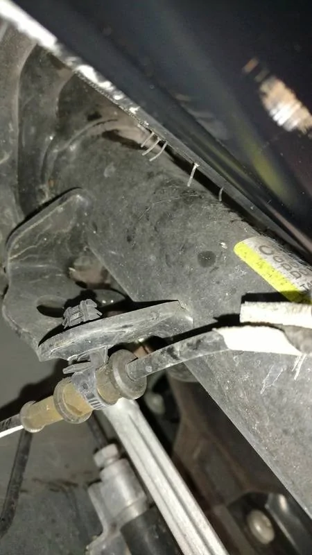

Thanks for the info guys. Apex EC-7 18x10 wheels came today and I pulled the trigger on the 285/35 RS4s. Ordered 15mm spacers and waiting for them to arrive. For kicks bolted the wheels and tires up. REALLY close, about 3mm of clearance between strut and tire without spacers on totally stock suspension.

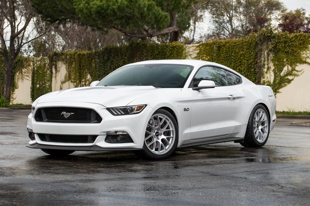

We are excited to have the 18x10” ET43 EC-7 wheels for Mustang BACK IN STOCK! A fellow enthusiast Kevin shared some photos of his White S197 Mustang 5.0 with his newly mounted EC-7’s. Kevin replaced his 20” wheels for this lightweight track setup, and next on the list is to raise the ride height just a touch.
  • APEX Wheels: 18x10” ET43 EC-7 in Anthracite (square)
  • Tires: 285/35/18 Toyo T1 Sport Tires
  • Suspension: ST XTA Coilovers, Cortex Watts Link & Whiteline Front Sway/Lower Control Arms
  • Brakes: The front and rears are off a 13/14 GT500. 15" rotor in the front with the 6P Brembo brakes. Rears are 13.8" rotors with a CNC caliper relocation bracket.

Got the EC-7 18x10, 285/35/18 RS4 setup figured out on my 2016 GT PP with completely stock suspension. 5mm spacer and longer studs looks like it will work just fine for track duty. Ill get some better pics this weekend.

Without spacer the tires were very close to the strut. The little tire hairs are touching. It's around 3mm of clearance. This is all on a 2016 GT PP with completely stock suspension.
With 5mm spacers. Everything clears just fine.

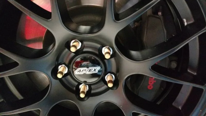

With the 5mm spacer I couldn't get enough thread engagement on the stock lug nuts (only around 5 turns or so) So I had to go with longer studs too. 3mm was the largest spacer that I could go and still get bout 7.5 turns with the stock lug nuts.
