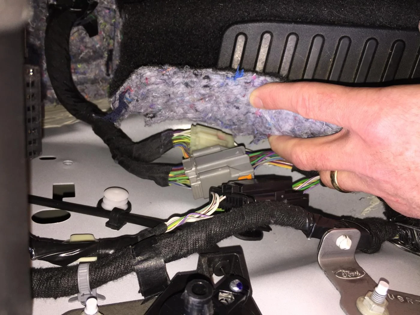

Looks like all the wires for the Diff Pump and Diff Temp sensor come out of the PCM and BJB. However, they stop at the connectors at the left and right kick panels.
Here is the left side. Connector C264 is the white one (hardest to get to). Four wires run through this connector; Diff temp sensor and return, Diff pump speed control and diag. On the right side, two wires run through connector C215; hot and run/start (relay) (not pictured).

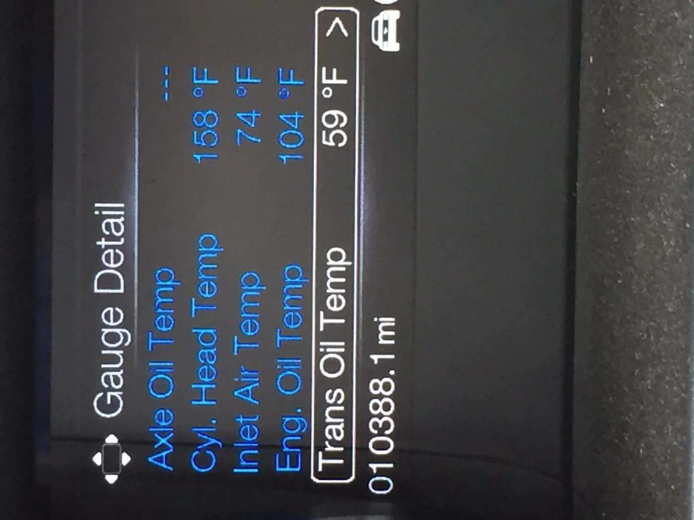

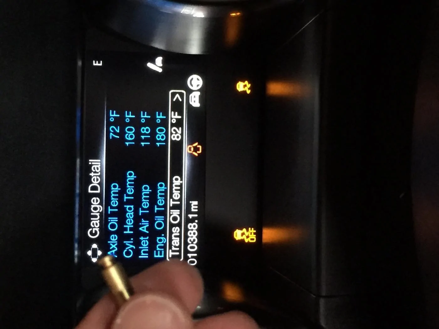

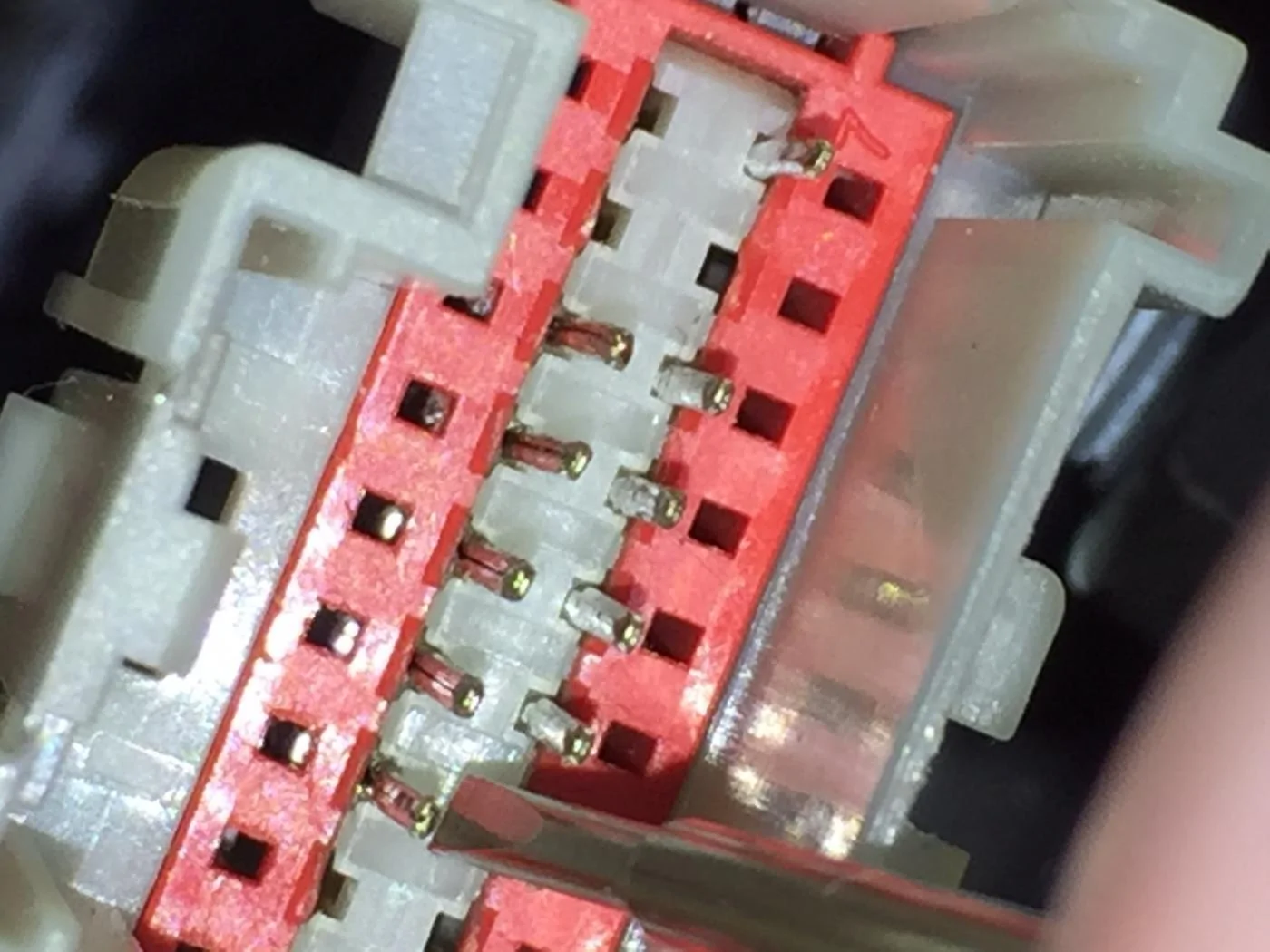

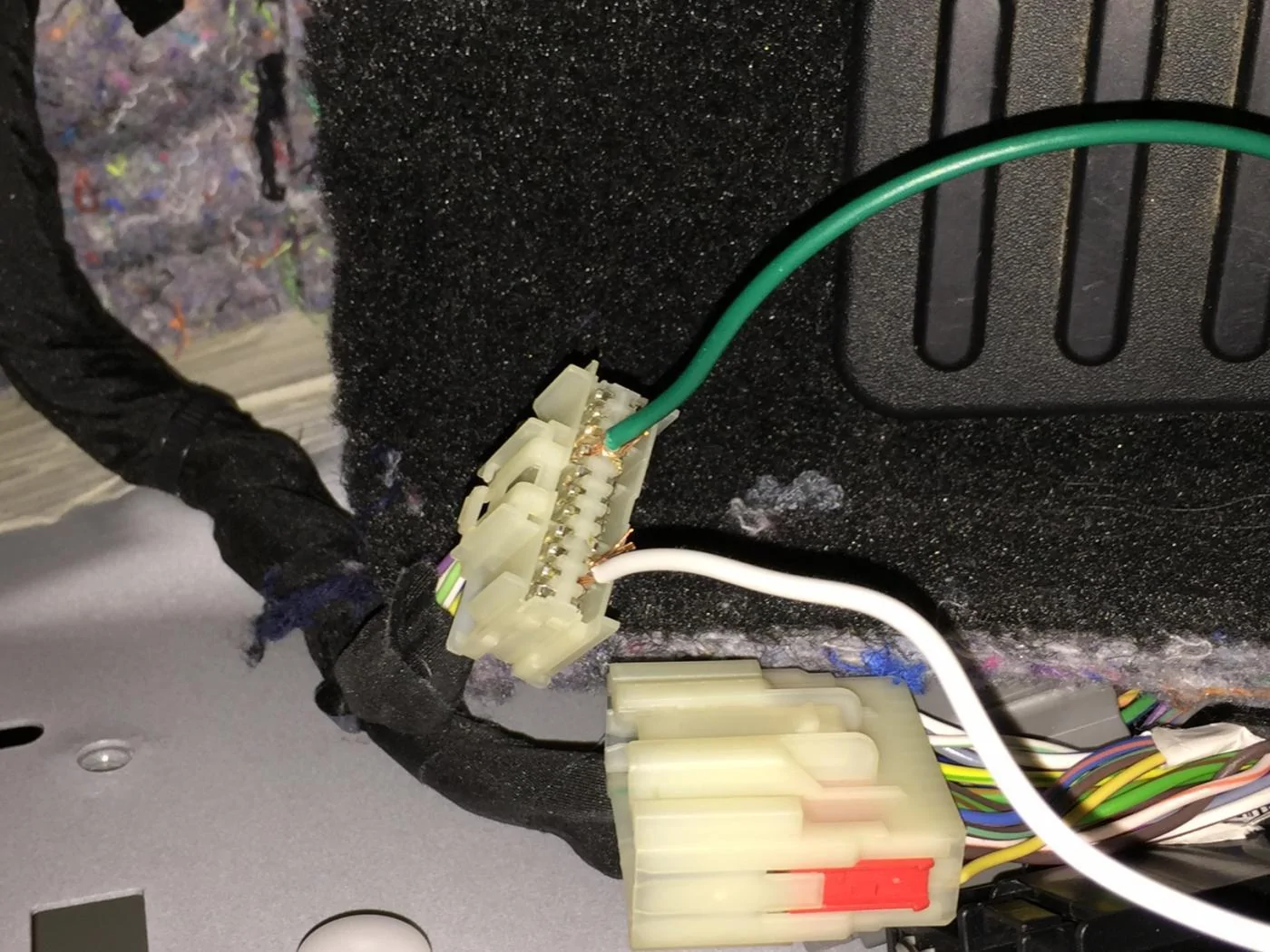

To check if the temp sensor would work, I just ran two leads to connector and the sensor; pin 4 (green) is the sensor wire and pin 21 (gray) is the return.
I'd like to use this connector to run my wire. Does anyone know where I can get these terminals? I've looked at Terminal Supply, Waytek, DelCity, but can't tell what I need. I'll need other terminals for the other connectors too. Starting here because I thought it would be easy to check if the sensor worked.
