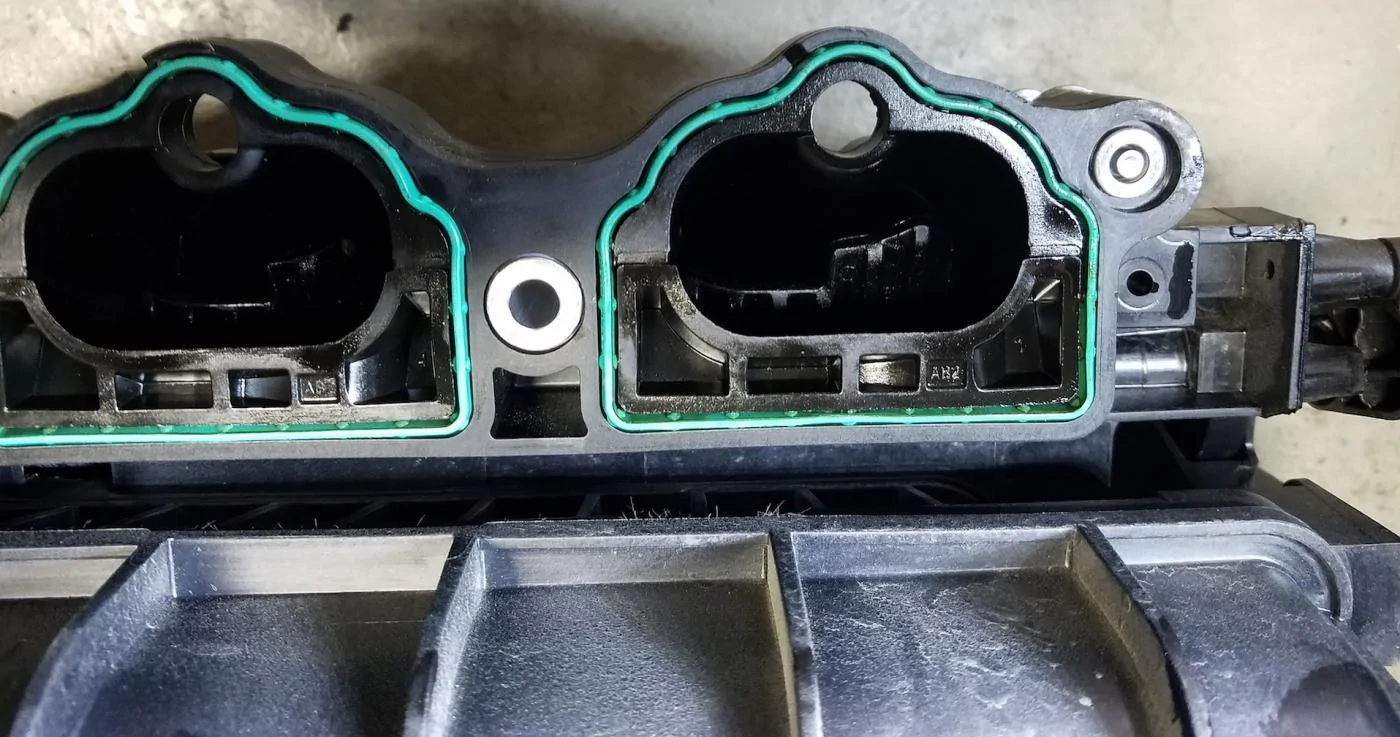

Found it for You. Even has information from Ford Techs you can take to your dealer.
Please note. This guy is a genius!!Check the intake manifold. A bunch of guys are having this exact same issue. It's turning out to be cracked manifold runners or IMRC valves broken. There's a thread here if you search around.
I had the same issue with mine last week. Thanks to this thread, we had it figured out quickly. Dealer replaced the IMRC and, fingers crossed, so far she's running great.
