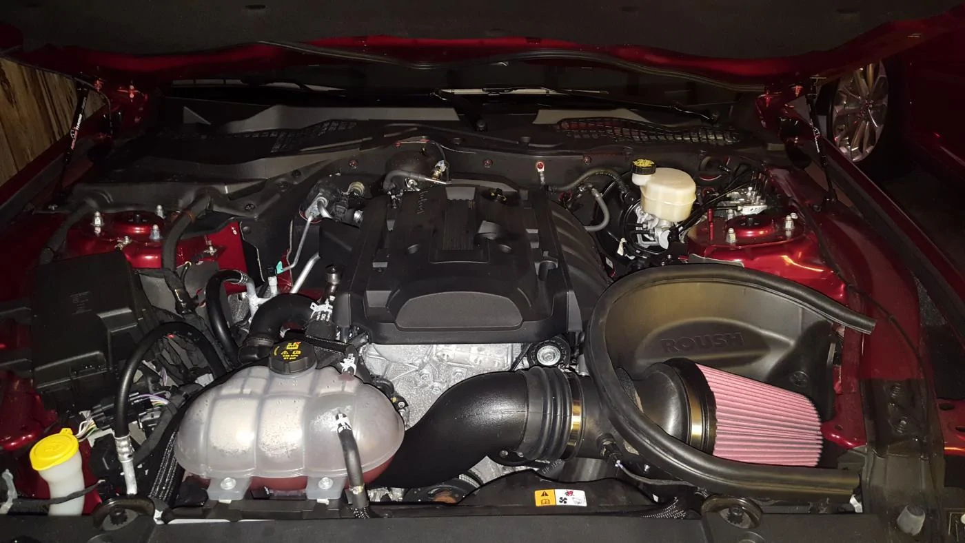

Like this?I make holes on the driver side grill in order to create a straight path for the air into the airbox. Inlet pressure now shows 0.04 to 0.08 PSI while cruising. Max pressure loss observed was -0.71 PSI during WOT with about 25.54 PSI of boost. So there is a measurable difference from makes those holes, just not sure if it's big enough to make any difference in performance.
